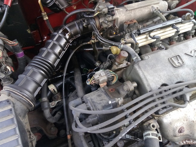

On top of VTech solenoid is the oil pressure switch, oil is squirting out from there. There are bolts holding it on so I assume there is a gasket to replace but I cannot find it. Or can it not be replaced?

Yes, it has an o-ring. Did you not locate? I can give you the Honda part number if needed. Hope this helps and thanks for using 2CarPros.

Was it the o-ring that was leaking?

Yes, have not had a chance to fix it.

Leak fixed. Added note when putting back together make sure you put it on the way it was. There is a circle thing inside that rotates, not sure what it is. Car would not start so I thought I would spin it in a different direction and started up.
