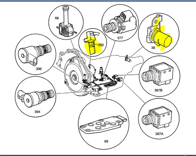

Can you please tell me where the vehicle speed sensor location is? I've replaced the 2 in the tail shaft of the transmission that thread into the location but apparently there's a 3rd that has a bolted hook connected to it but i cannot seem to find it. Also, i have replaced the 2 front ABS wheel sensors and no change. My vehicle will not shift at proper times and the speedometer will not work at all. I've searched numerous times but cannot find any information on it. Also, i have seen the posts online and all the pictures on here and they only point to the 2 sensors i have already changed.

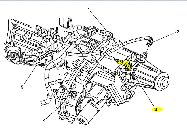

Take a look at the two pics I attached. There is an input and output sensor related to the transmission. There is also one in the rear of the transfer case.

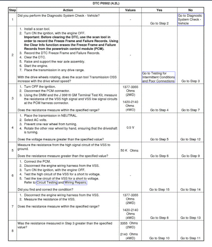

I attached the pics below showing them. Let me know which ones were replaced. Also, let me know what diagnostic trouble code was found.

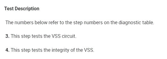

Joe, thanks for the response. Okay, so pic #2 are the ones i replaced. I'm actually looking for #36 in the first pic, that's the one i haven't found to replace.

That specific sensor is model-dependent. You may not have it on your transmission. If you do, it will be on the passenger side in the transmission tail housing. However, because this is a 4wd, chances are it isn't there.

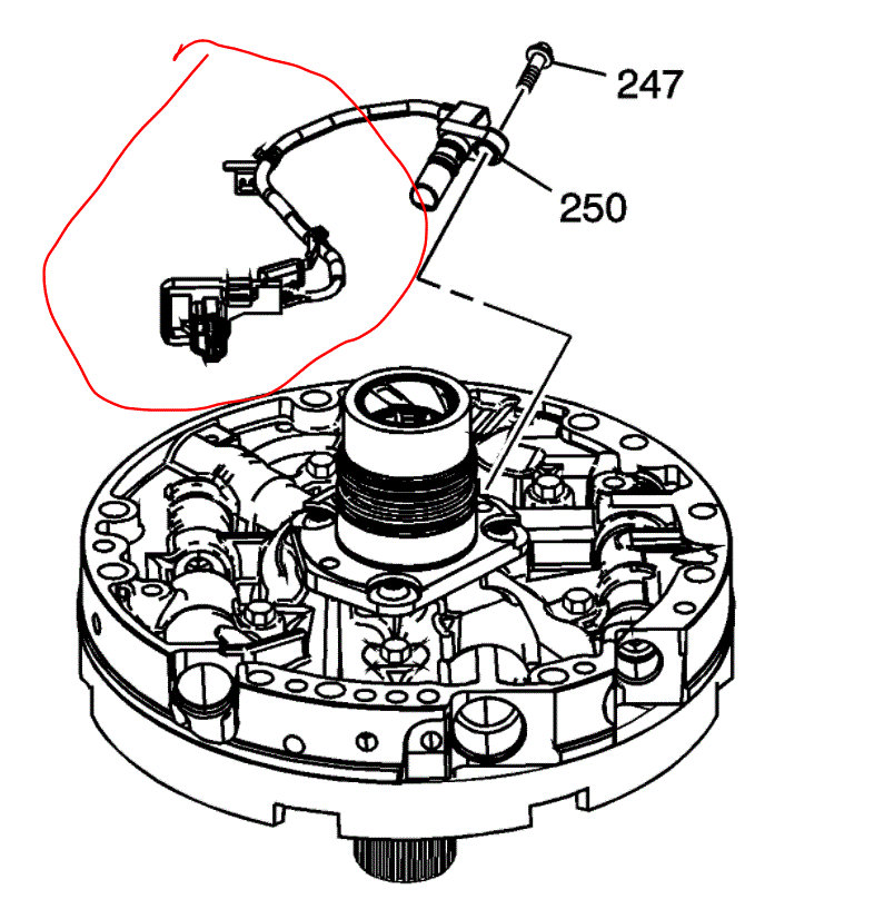

The two in picture two are on the transfer case tail housing. The one on the outside of the transmission (number 36 pic 1) is likely not there. It is likely for a 2wd vehicle. The only other one is internal, number 250. Is that the one you are referring to?
That is an input speed sensor located at the front pump on the transmission. See pic 1 below. Is that the one you didn't replace? Also, can you tell me what the code was you had that led you to the speed sensor?
See pic below.

That is the only one i havent replaced. I was not aware there was an internal speed sensor. The code i received was the p0502 code which led me to the speed sensor.

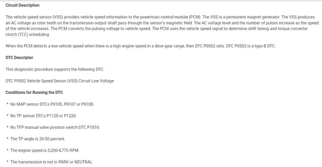

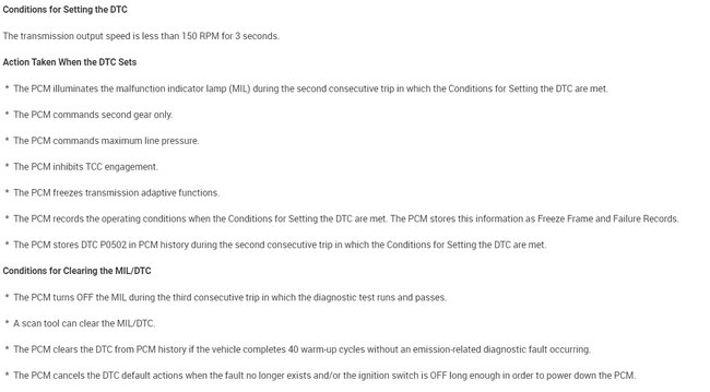

The input speed sensor works in conjunction with the output speed sensor to determine the speed and proper gear ratio. However, if the input one is bad, you will likely experience odd shifts, hard shifts, or codes specific to gear ratio issues. Other than the P0502, were there any other codes? Do the other gauges on the instrument panel work? Does the speedo do anything?
Also, the internal one shouldn't have an effect on the speedometer. That is the one at the rear of the transfer case that you already replaced.

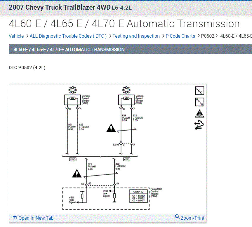

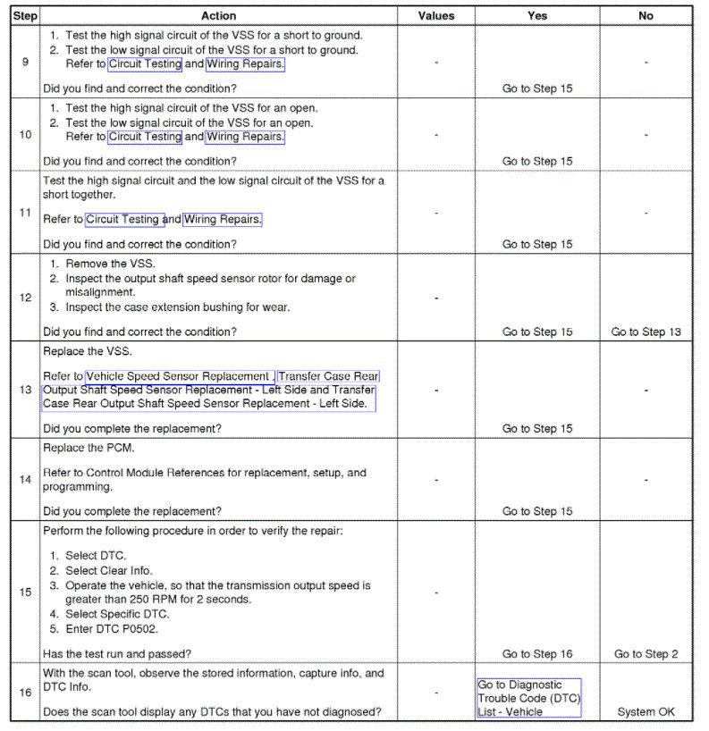

I attached the diagnostics for a P0502, which is specific to an output speed sensor. Take a look through them and let me know if you are comfortable performing them.
Here is a link that you may find helpful:
Let me know,
