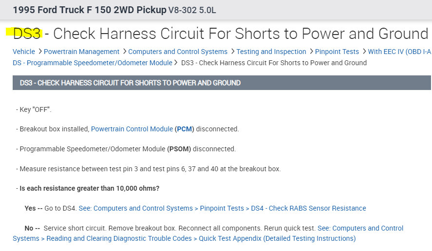

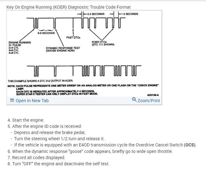

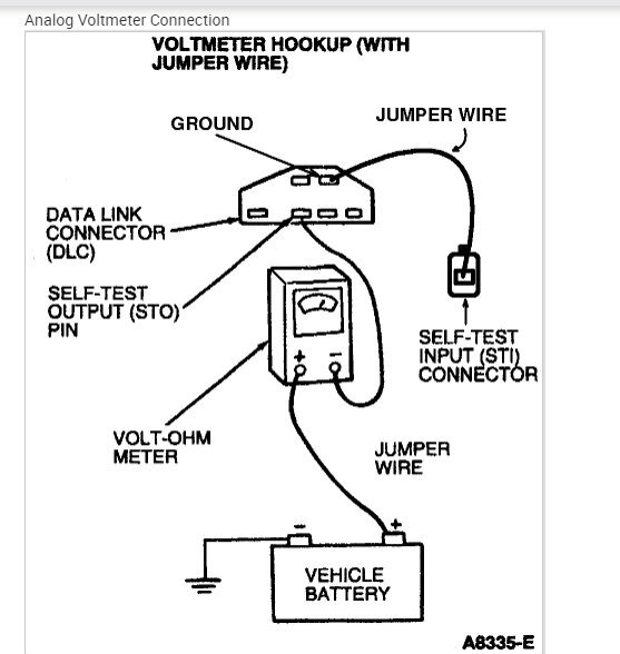

obd1 code 452, shifter stalk flashing OD light.
No noticeable shifting problems in transmission.
Slight sweeping of speedometer gauge above 60MPH.
Same issue about a year ago, replaced transmission output sensor (OEM / Interchange Numbers: F4AZ7H103A).
Code returned after drained battery, jump start and drive to get battery replaced.
Assumed cheap aftermarket sensor, replaced again. Light still flashing, same 452 code.
No other codes present.

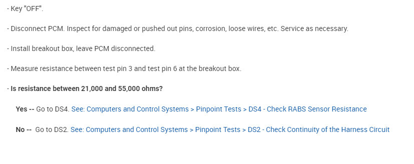

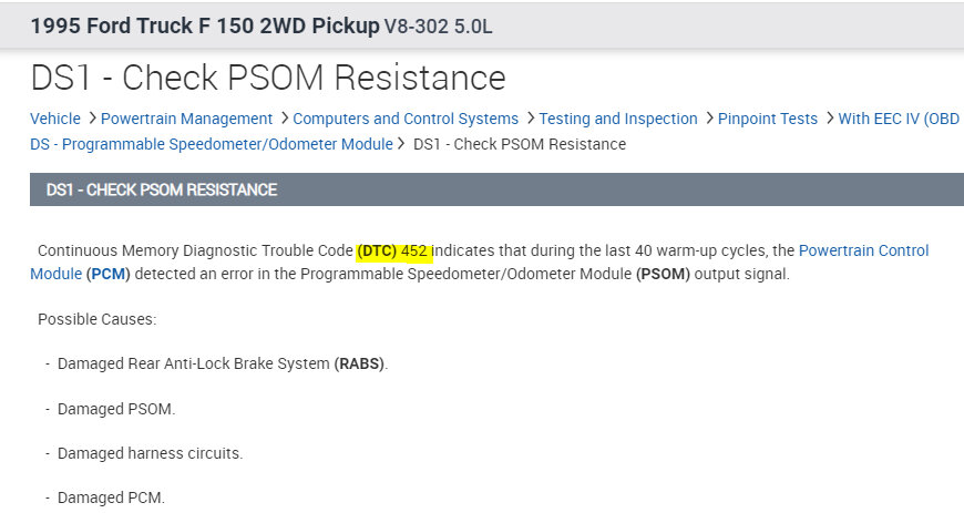

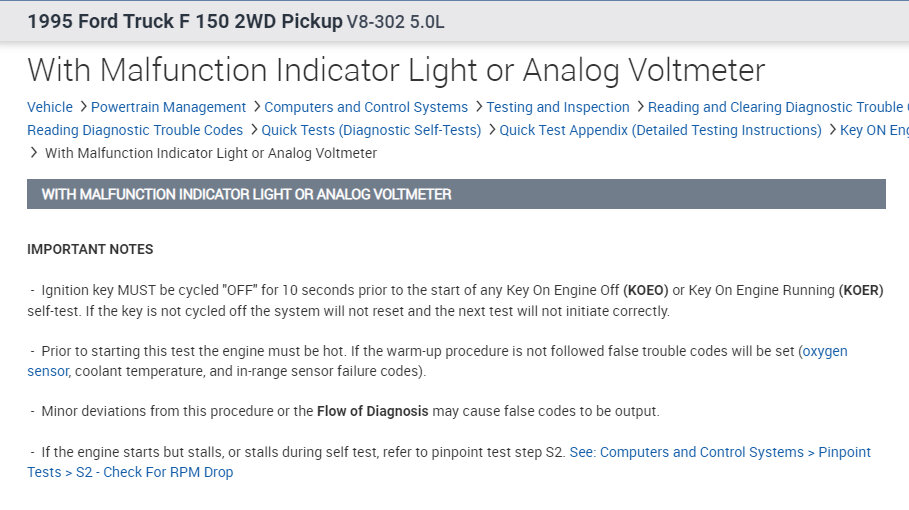

Is this the only code present? As far as the code, it indicates there is an error in the programable speed/odometer module. Because this can be caused by a few different things, we need to work through a few tests.
The problem is my manual provides one procedure and then based on the outcome; it sends me to the next.
Do me a favor. Take a look at the first step below and let me know if you are comfortable performing it. If you are and complete it, let me know the results.
Take care and let me know what you find.

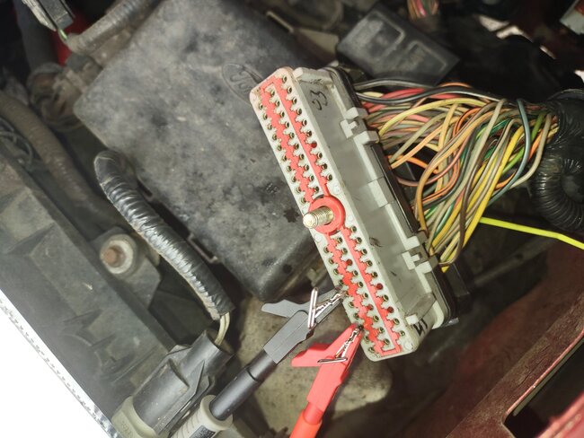

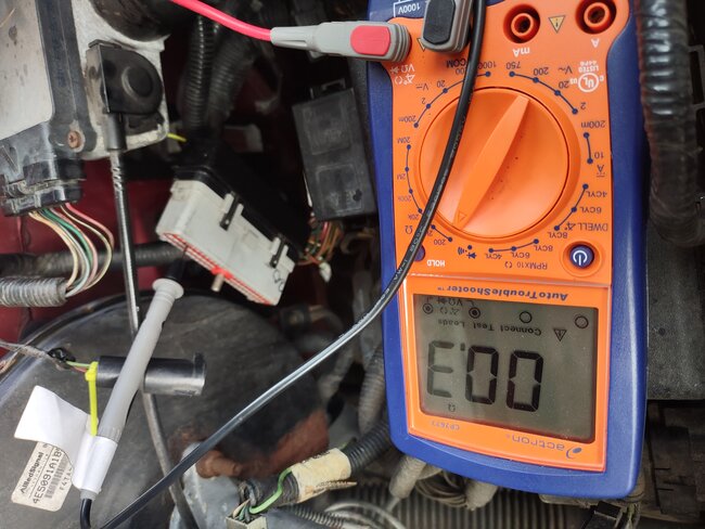

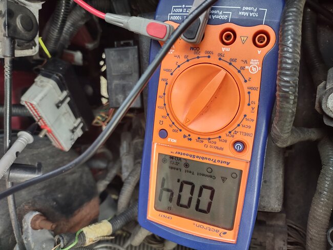

I do not have a breakout box; can this be measured from pins 3&6 on the PCM connector?
I should have mentioned in my request for help that I have a spare PCM (cardon reman) and have tried that with no change.
Nov 12, 2022 at 8:18 PM
KELLER1966
  • 12 POSTS

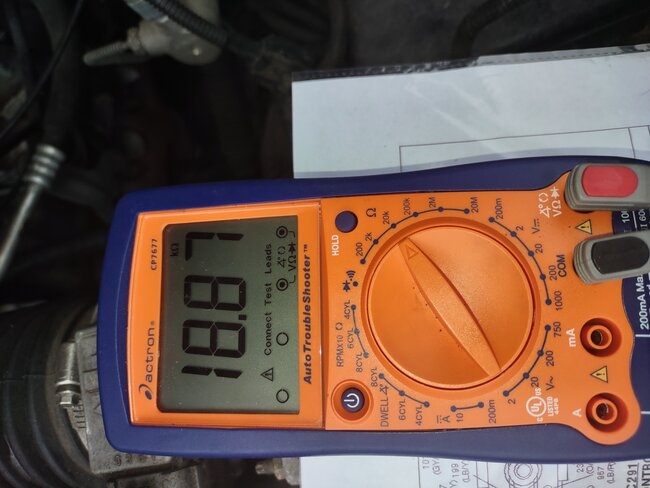

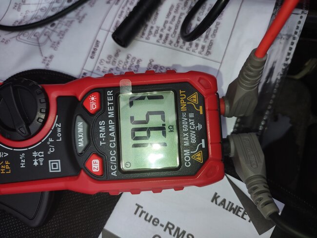

Checked at PCM connector with one auto ranging and one set at 20k.

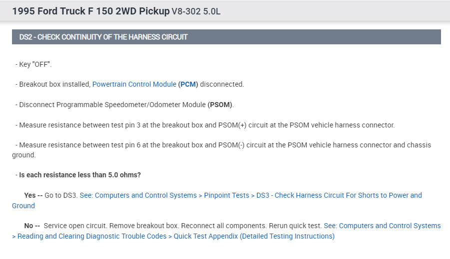

I attached the next two steps because the outcome can either require more testing or it can be an open circuit that needs to be repaired.

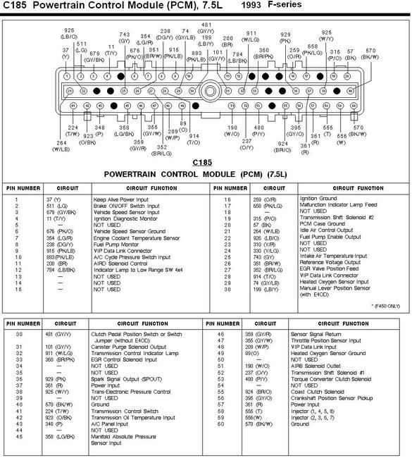

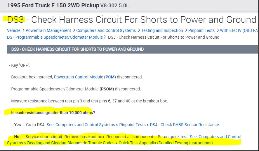

Thank you, Joe, for being patient with me, continuity and short to ground pin check is good.
PCM 3 to PSOM 5= 0.3ohm
PCM 6 to PSOM 7= 0.4ohm
PCM 3 to PCM (6,37,40) OL

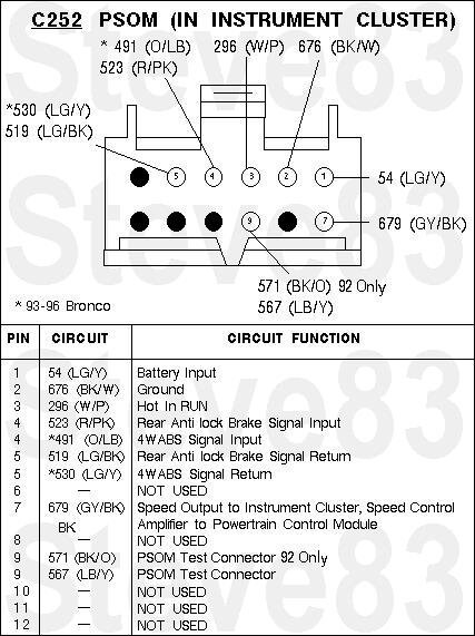

I have included the connector pinout I have been using with this test.
Nov 26, 2022 at 11:45 PM
  • 110,248 POSTS

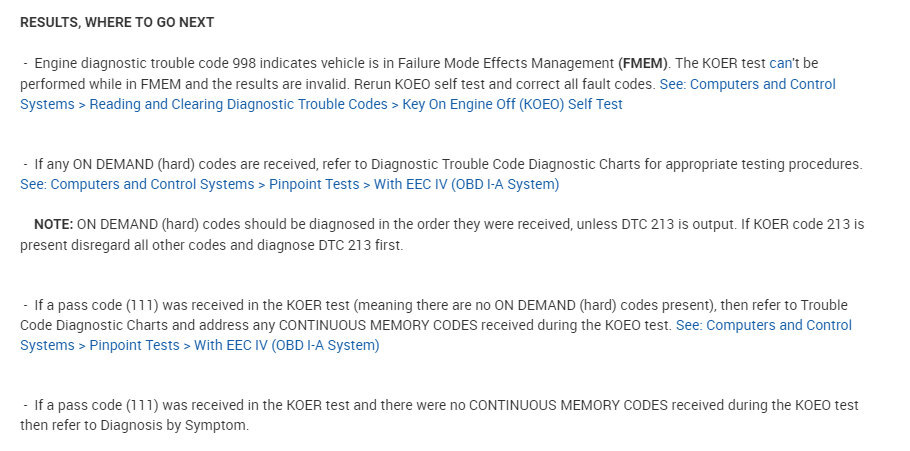

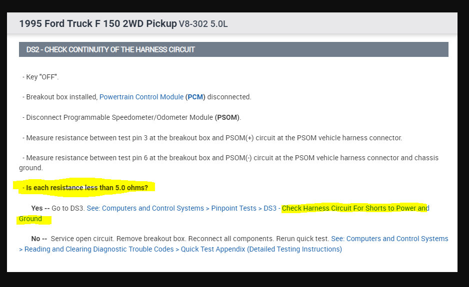

Based on the results, we have a short. The manual is suggesting that everything be reconnected and then rerun the quick test.
Starting with pic 2 is where it goes next. Let me know what you find.

At what step determined a short. I would like to recheck that step before I continue. I thought my results would lead to test DS4, checking the RABS module .
Nov 29, 2022 at 5:31 AM
  • 110,248 POSTS
checking for a short to power or ground was done in the first portion of the diagnostics. I reattached it below.
Let me know if this helps.
See pic below.
Nov 29, 2022 at 11:31 AM
KELLER1966
  • 12 POSTS
I believe I must have miscommunicated my reply. When checking from pin 3 to Pin 6, 37 and 40 I gave you an answer of OL. I meant open loop for no continuity between any pins. That would be yes all above 10,000 ohms.

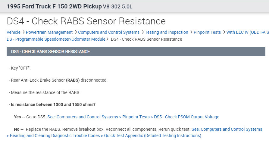

No problem whatsoever. If that is the case, we need to jump to DS 4. Take a look through the diagnostics. I have a feeling this is going to be an easy one for you.
See pic below.

Yes, resistance check is good.

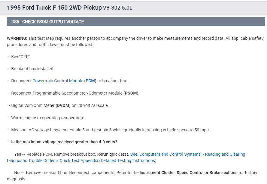

Let's move on to DS 5. I attached it below. Let me know the results or if you have questions.

No AC signal between pins 3 and 6.

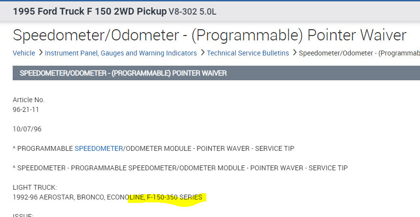

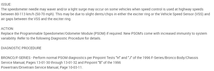

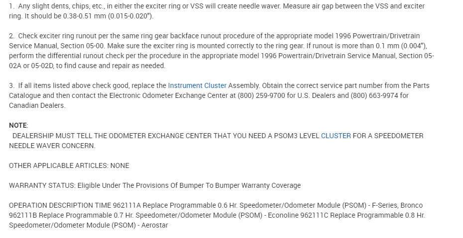

I was ready to move to an instrument cluster test, but I think we found the issue. Take a look through the technical service bulletin I attached below. You indicated the sweeping in the speedo.
Let me know your thoughts.
Dec 9, 2022 at 1:27 PM
KELLER1966
  • 12 POSTS
Yes, I agree the PSOM needs repair. There is an AC signal on pin 4 from the VSS but no output on pin 5 to the PCM. I only got 2.9 volts on pin 4, is that adequate voltage? If not do you have a check for the servo amplifier or the ABS module to determine what is pulling the signal down.

Take a voltmeter and check the signal return voltage to ground. Let me know what you find. Also, check pin 4 voltage to ground.
Pin 4 should be around 5v. If you ground the return voltage (pin 5) to a known good ground, it may indicate a return. If it does, the PSOM may be faulty.
Dec 24, 2022 at 8:46 AM
KELLER1966
  • 12 POSTS
Sent the PSOM to Texas Speedometers for repair. Got it back in just over a week. No codes, no flashing stalk light, all is right with the world again. Thanks again for all your help.
