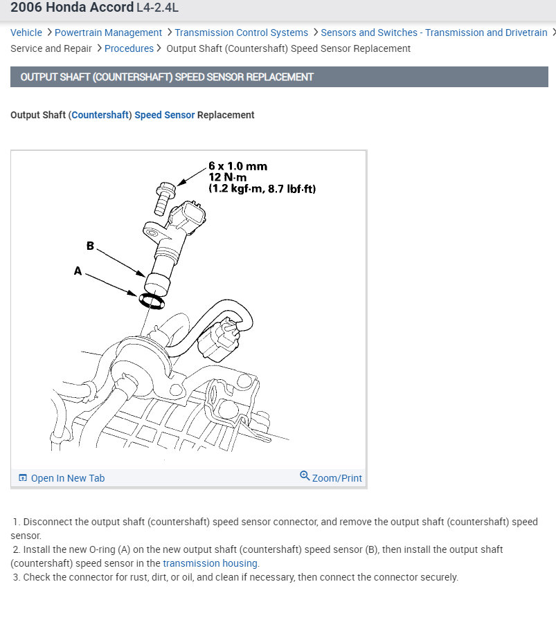

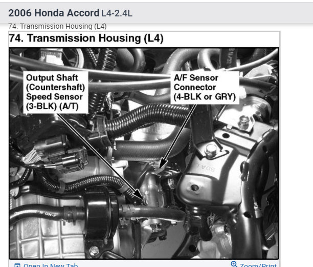

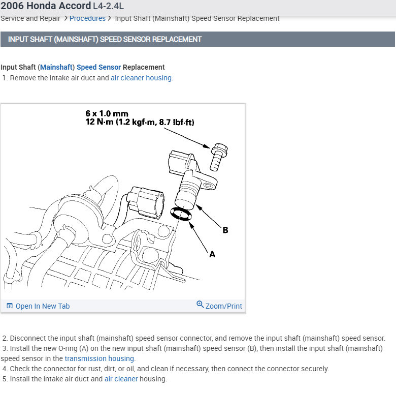

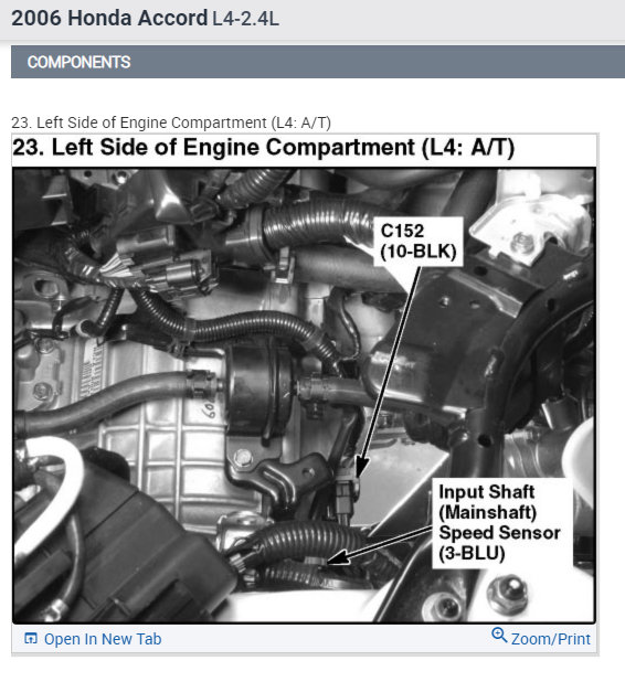

my engine light came on and it showed the code for the VSS sensor. i haven't been able to find any records where the VSS input and output sensor for my car listed above, two door, are located. may you show me a diagram of the location of each sensor?
Aug 1, 2022 at 8:43 AM
SQM
  • 6,383 POSTS
The input shaft sensor is located on the left side of the engine compartment and the output sensor is on a transmission housing.
I have attached diagrams below for your reference.
Let me know of any questions.
