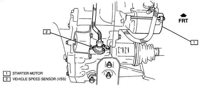

I'm trying to locate the vehicle speed sensor but having a hard time.
Jul 30, 2020 at 7:59 PM
  • 110,194 POSTS

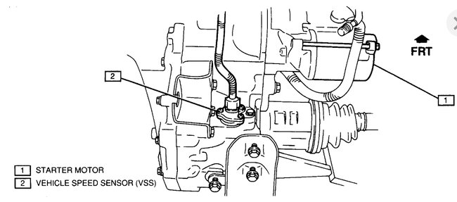

The vehicle speed sensor is located near the starter motor. I attached a pic for you.

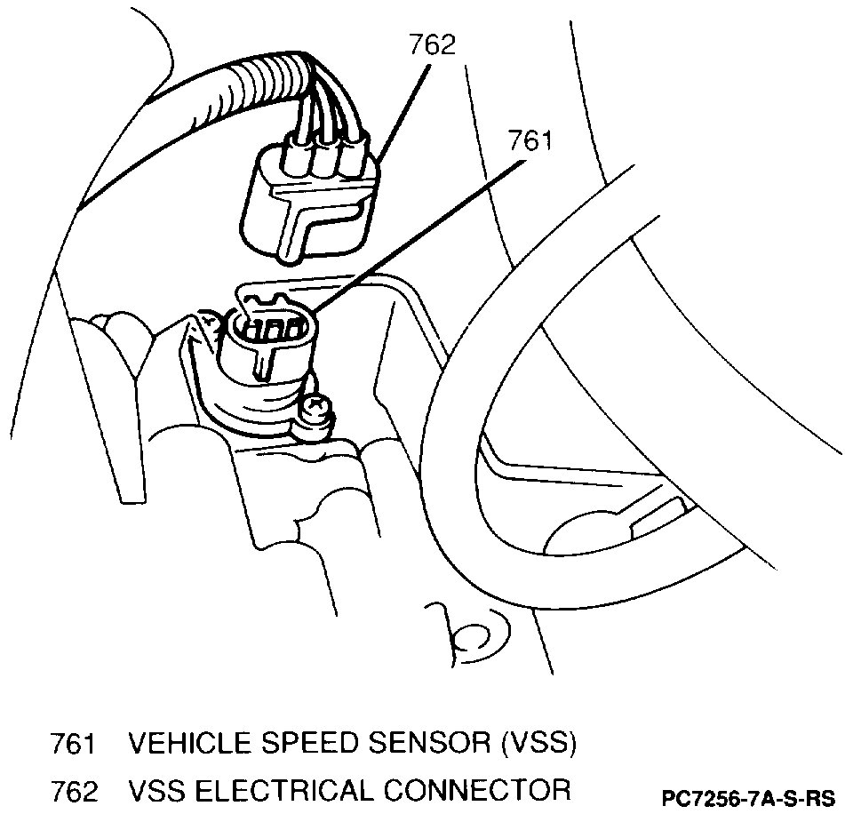

Here are the directions for replacement. Pic 2 correlates with the directions.
___________________________________________
1994 Geo Prizm L4-1.8L DOHC
Manual
Vehicle Power-train Management Sensors and Switches - Power-train Management Sensors and Switches - Computers and Control Systems Vehicle Speed Sensor Service and Repair Procedures Transmissions Manual
MANUAL
Remove or Disconnect
1. Negative (-) battery cable.
See pic 2
2. Vehicle speed sensor (VSS) electrical connector from VSS.
3. One retaining bolt and VSS from trans-axle case.
Inspect
1. VSS driven gear for excessive wear or damage. Replace VSS as necessary.
Install or Connect
1. VSS into trans-axle case; secure with one bolt.
Tighten
^ Vehicle speed sensor (VSS) bolt to 11 Nm (97 lb.in.).
2. VSS electrical connector to VSS.
3. Negative (-) battery cable.
Tighten
^ Negative (-) battery cable-to-negative (-) battery terminal retainer to 15 Nm (11 lb.ft.).

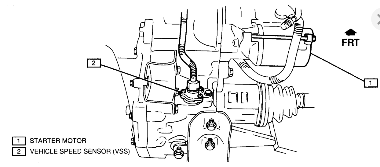

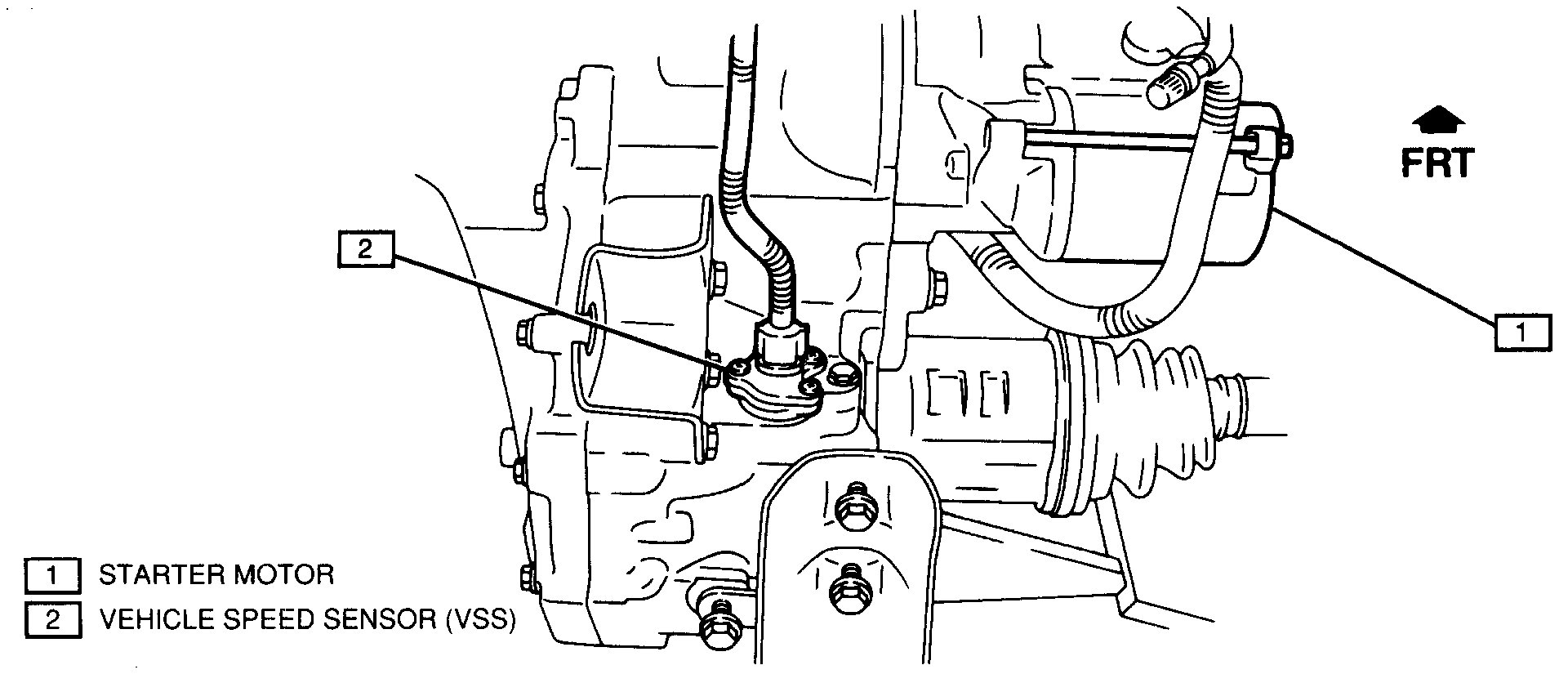

Hello, I'm Danny.
Here is the information you requested.The VSS is mounted on the trans-axle next to the starter motor CV axle. I've attached a picture below of its location.Hope this helps and thanks for using 2CarPros.

So I should be able to see it from above correct?
Jul 30, 2020 at 8:35 PM
  • 110,194 POSTS
It may be blocked to see from the top by the transmission housing. Let us know if you have other questions.
Jul 30, 2020 at 8:42 PM
JOHN BURDG
So I should locate it through the bottom?
Jul 30, 2020 at 8:44 PM
JOHN BURDG
I feel dumb right now, because i'm having such a problem finding it... I have watched videos, Googled pics....
Jul 30, 2020 at 8:46 PM
  • 110,194 POSTS
That is what I would suggest. Note that it will be tight if you don't have it lifted. Keep in mind, the starter is on the left hand side rear of the engine, so the sensor is likely not visable from the top.
