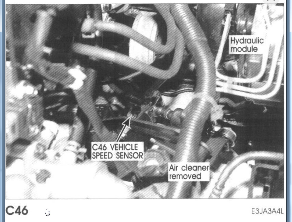

Speedometer, back up lights and cruise control are not functioning at all
106,000 MILES • 2.7L • V6 • 4WD
JENNYJEN1

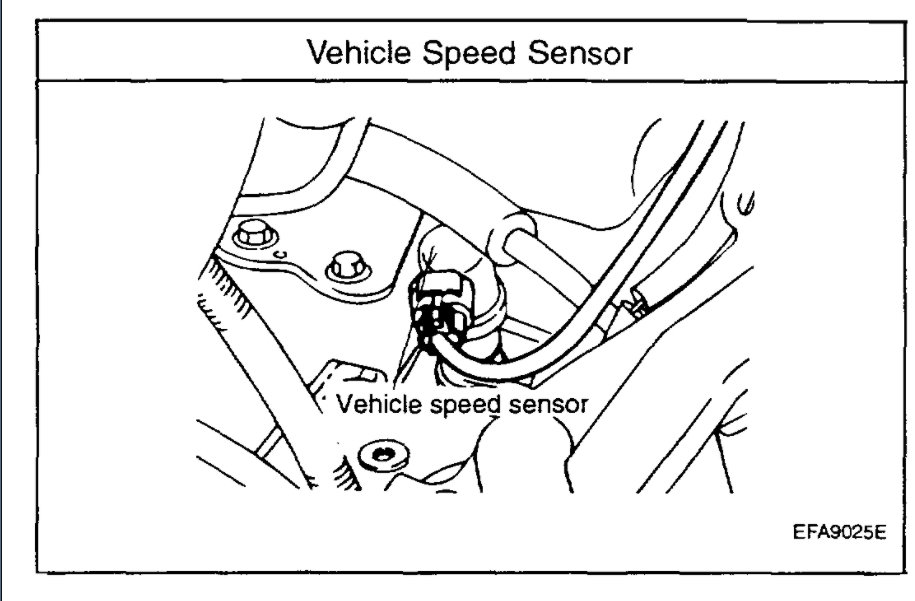

The fuses are good. I believe its the vehicle speed sensor (VSS) but am not 100 percent sure where it's located. Does anyone know?
Dec 6, 2020 at 9:38 PM
I am attaching the vehicle speed sensor location but just so I understand, these issues all happened at the same time or did you just notice it? I suspect these are separate issues so let's address them one at a time and if we fix all them at the same time then that is just a bonus.
Let's start with the speedometer as that may be the speed sensor.
I attached the location. However, let's start with checking for codes. I am hoping you have a P0501 and we can go from there.
