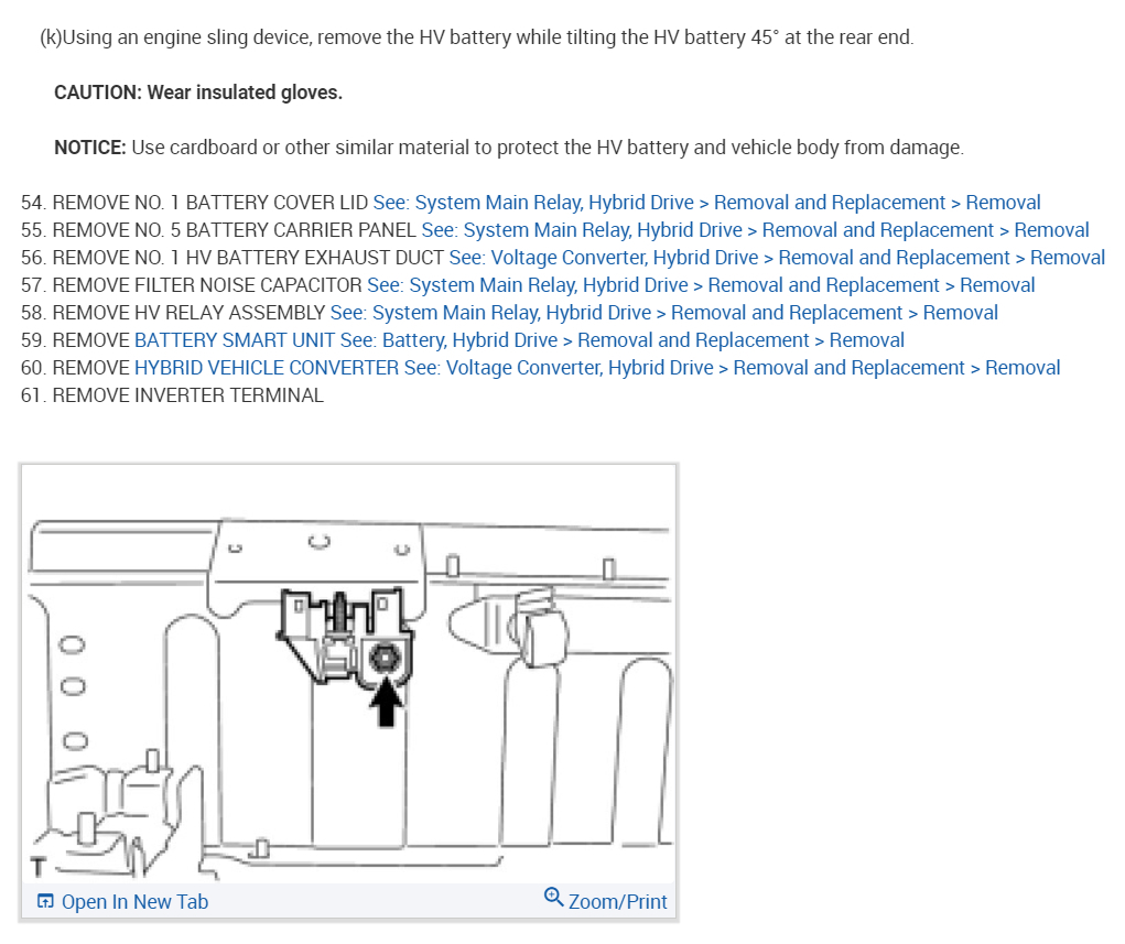

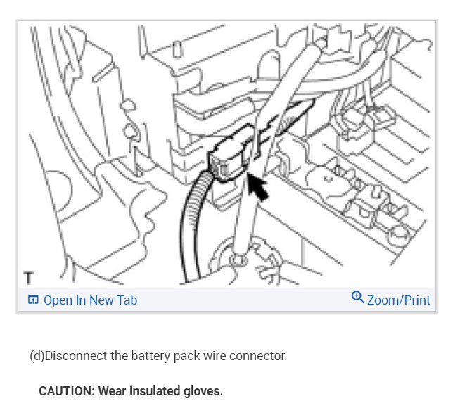

So we came home in the down pouring rain and the VSC, hybrid system and check engine lights all came on. Soon after the battery in the back started making a blowing noise, now the car is stalling and the battery shows it isn't charging.. Help!
Aug 3, 2019 at 7:09 PM
  • 54,878 POSTS

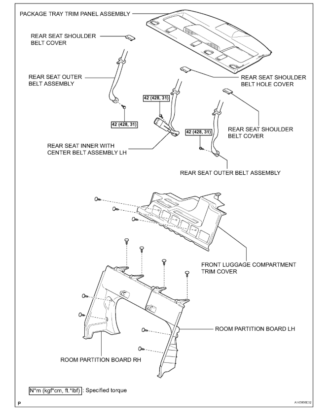

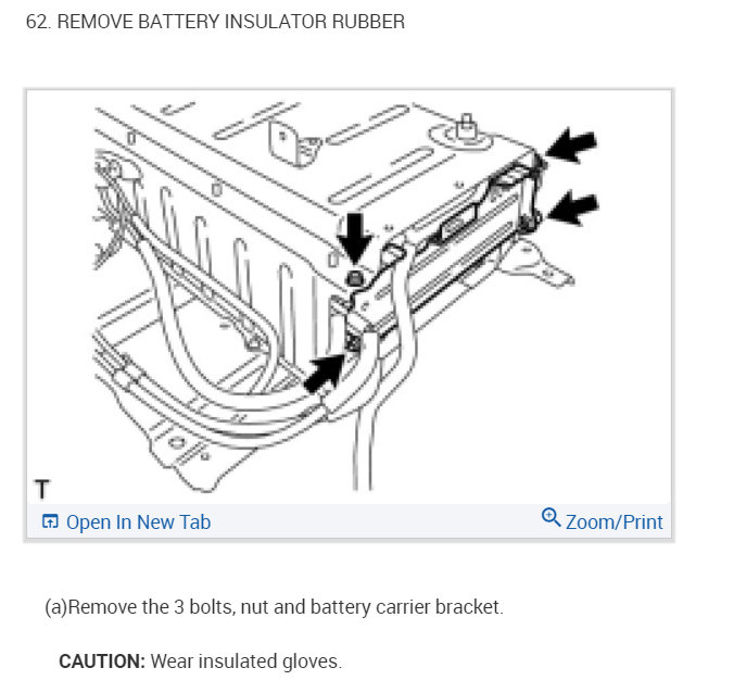

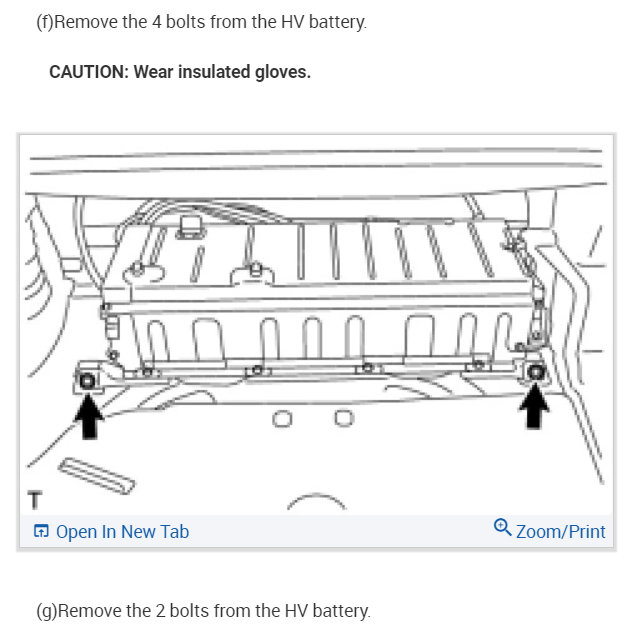

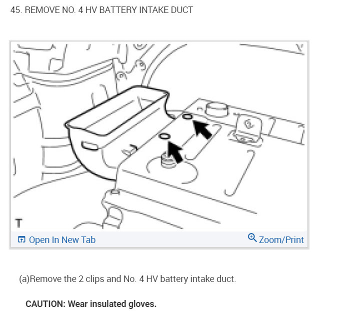

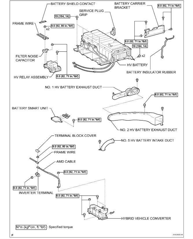

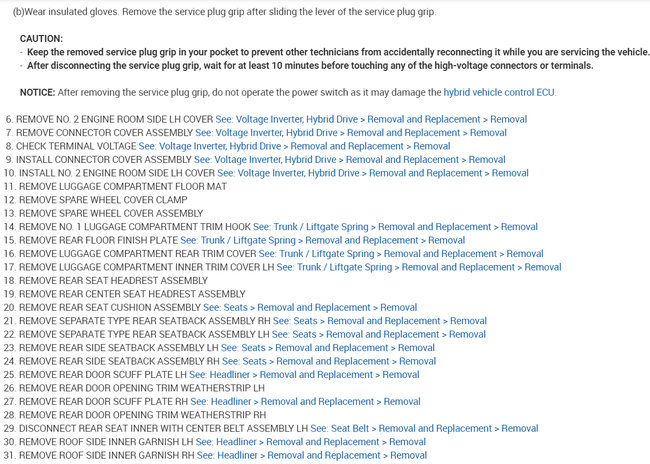

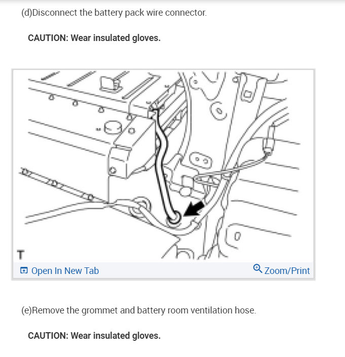

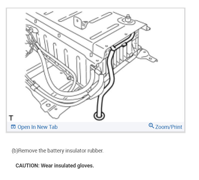

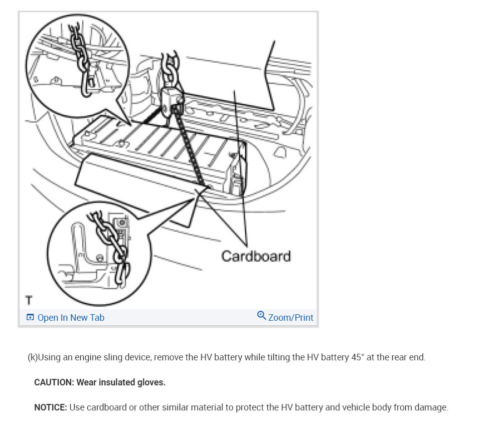

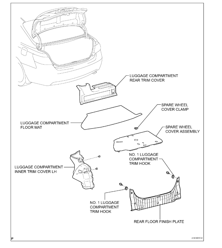

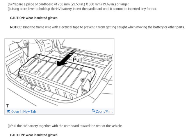

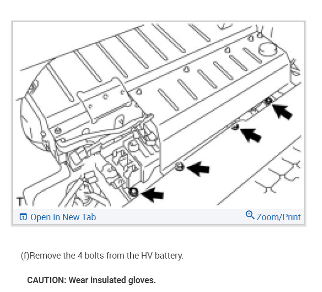

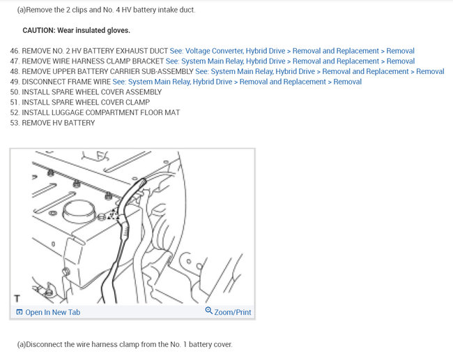

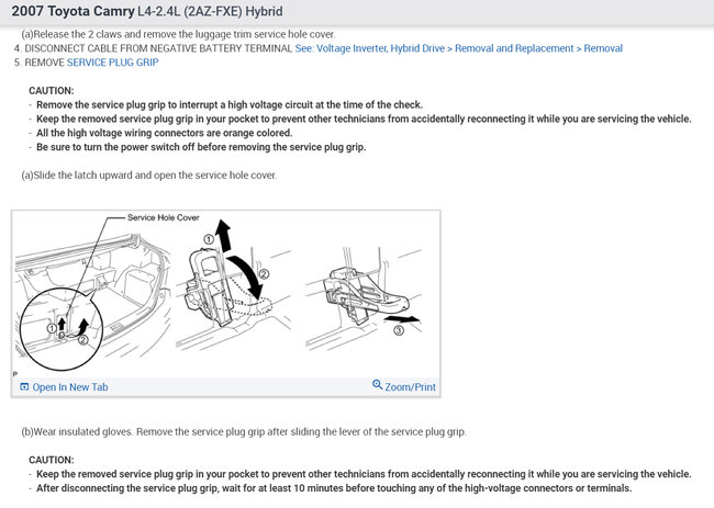

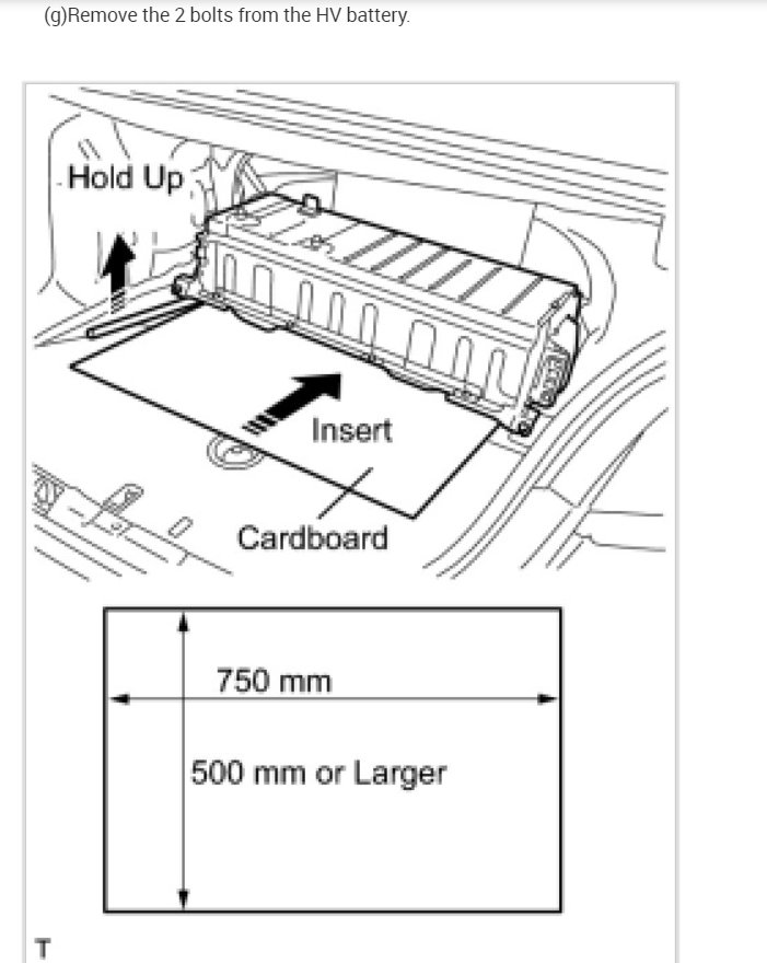

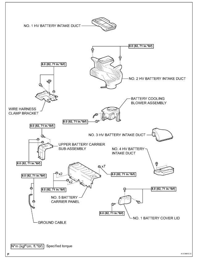

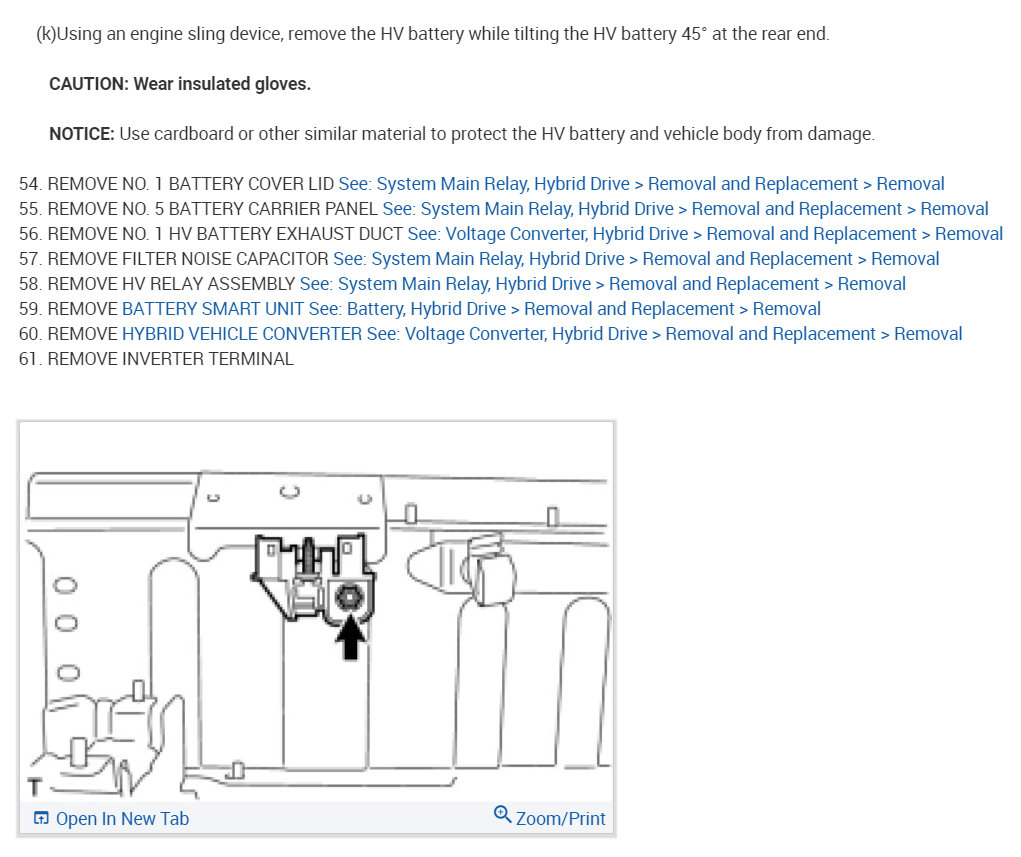

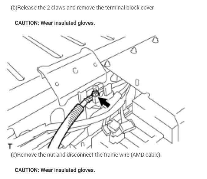

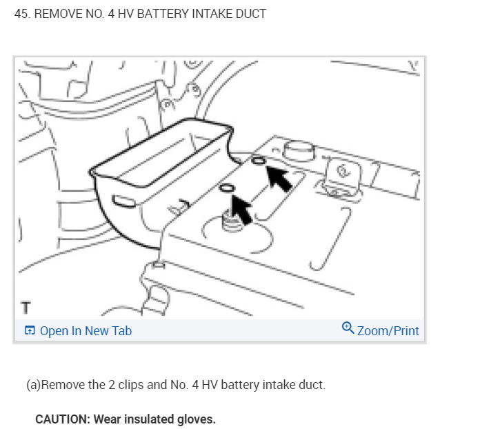

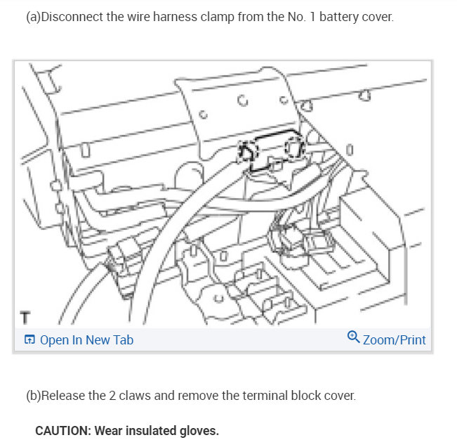

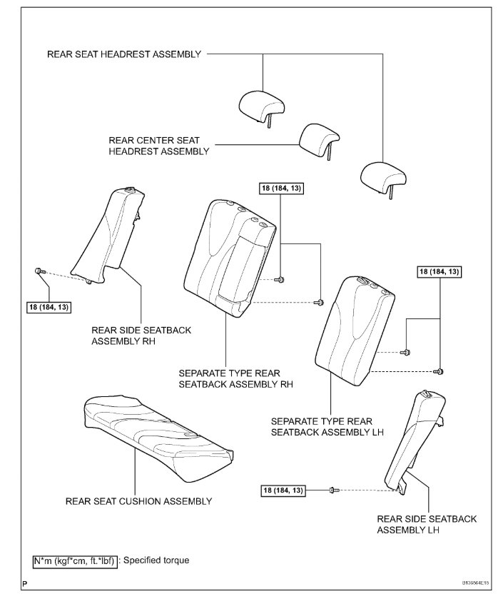

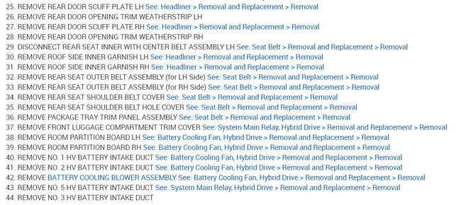

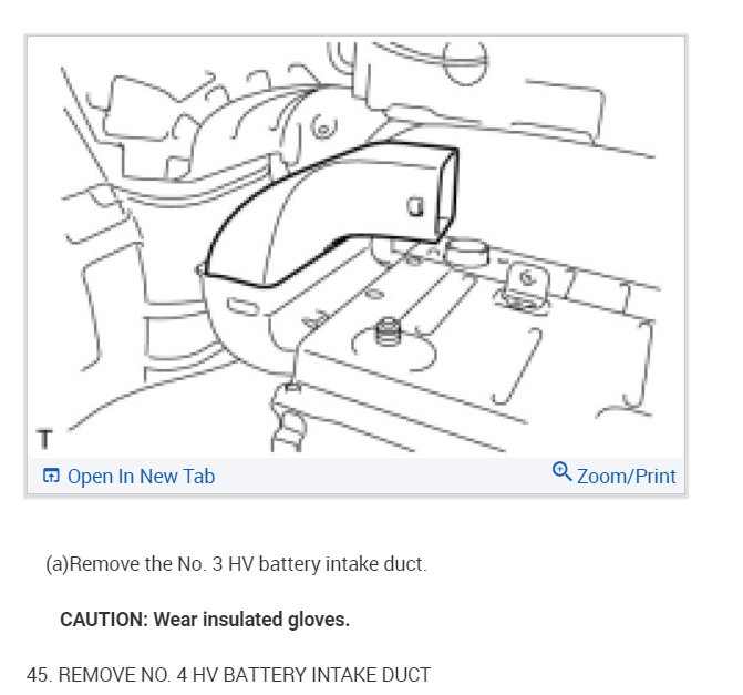

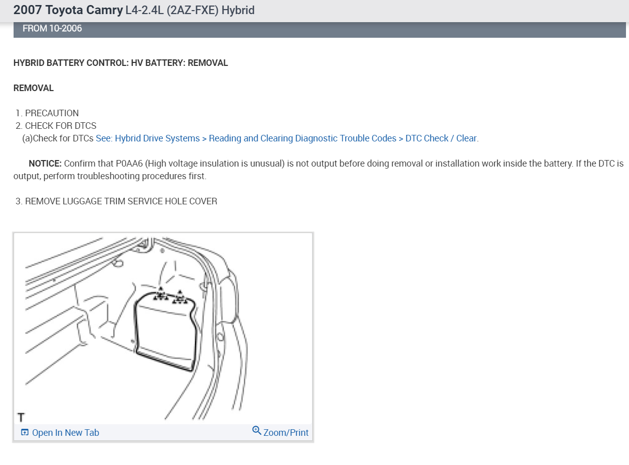

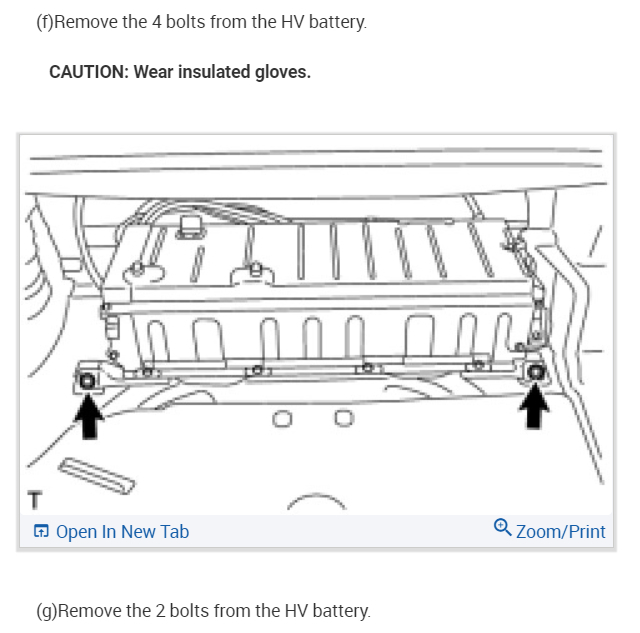

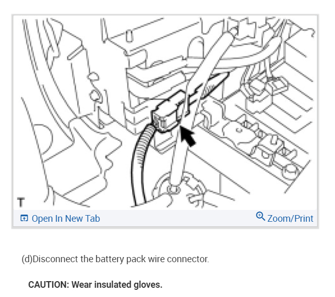

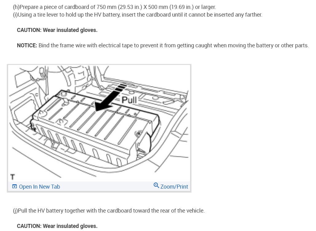

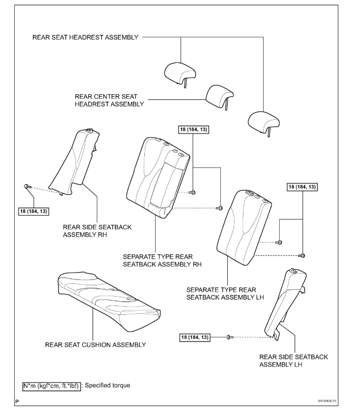

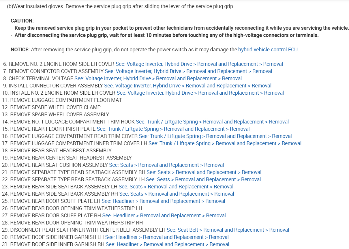

This is common when one or more cells have shorted out inside the hybrid battery pack. here is a guide that shows whats inside and instructions on how to replace the the battery in the diagrams with the exploded view as well so you can see how it works:
https://www.2carpros.com/articles/hybrid-battery-information
Make sure you wear insulated gloves when working with the hybrid battery. The Hybrid battery is heavy and you might need a hoist to lift it out. Also this is a high voltage system and you must follow the directions or personal injury can occur.
