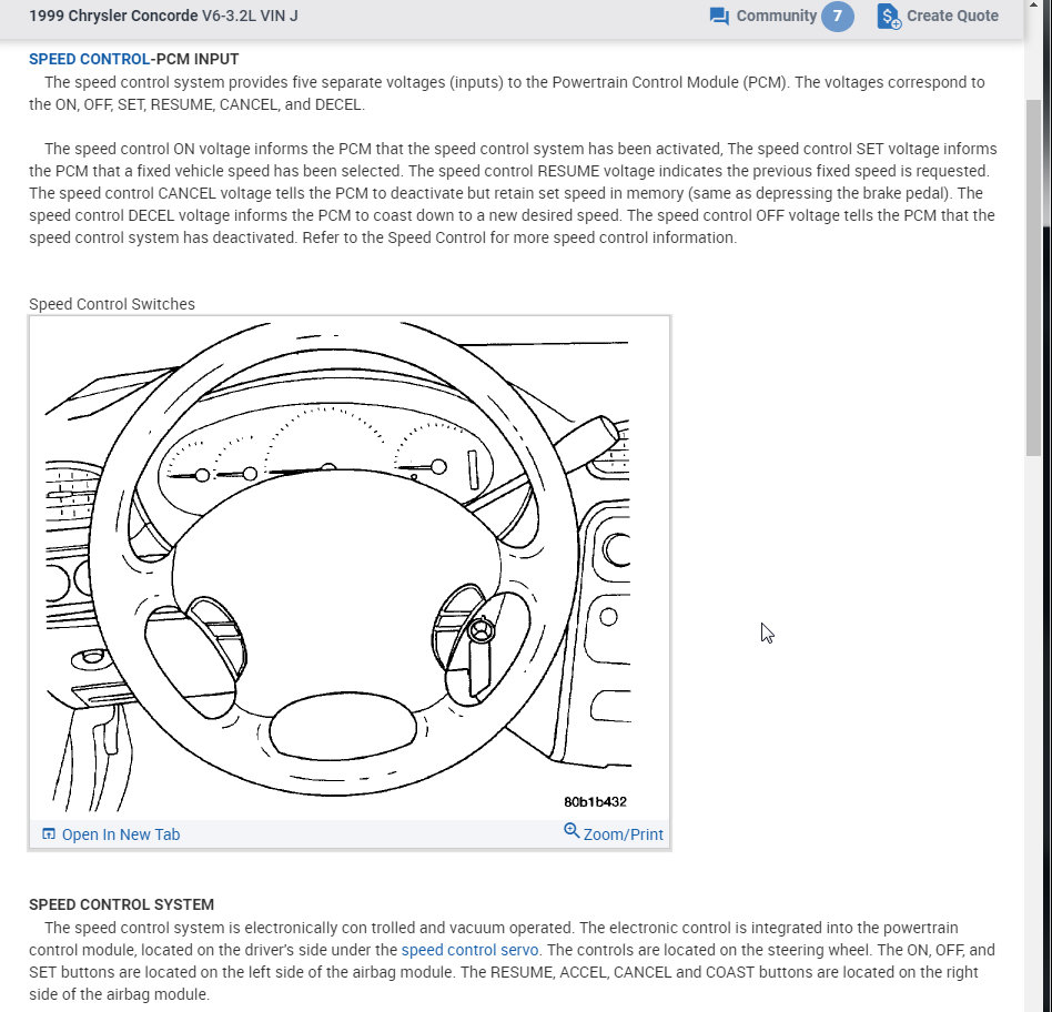

99 CC
It says Vehicle Speed Control on diagram under vehicle hood. I am also unfamiliar with term.
Mar 14, 2020 at 10:26 PM

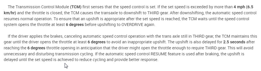

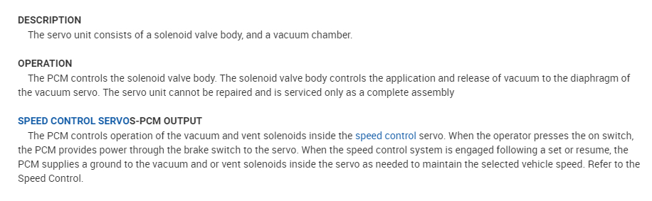

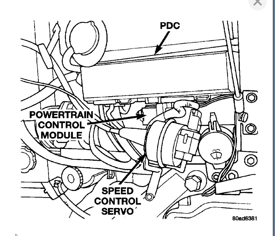

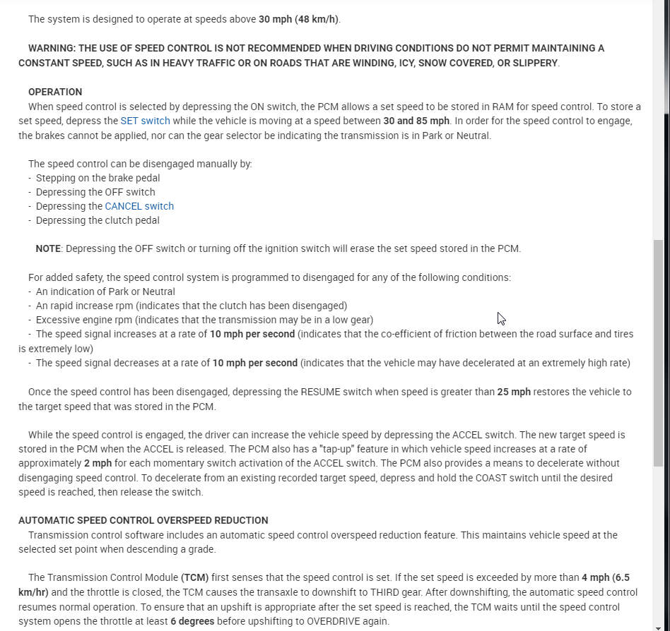

The speed control system is the cruise control system. I attached the info on this system below. I am not sure what the question was with hoses that attach to the VSC other than the hose that attaches to the servo. I attached this info as well. Let me know if you need more info. Thanks
