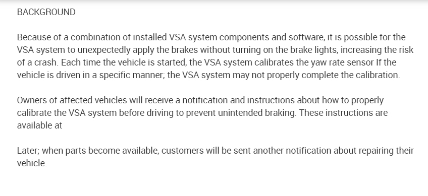

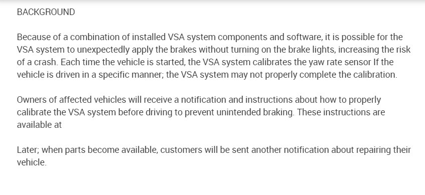

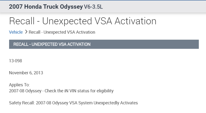

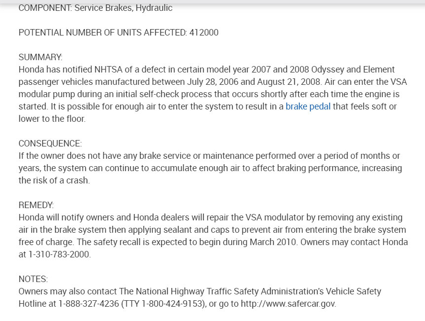

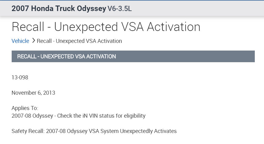

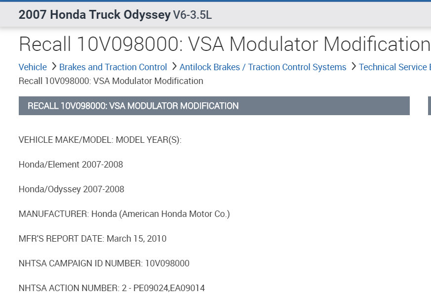

In the diagrams down below I have included two seperate recall notices for your vehicle, specifically 2007-2008 Honda Odyssey[3.5L], for the VSA system. You can either get ahold of your local dealership or the National Traffic Highway Safety Administration for more information. Please get back to us and let us know how everything turns out.
Thanks,
Alex
