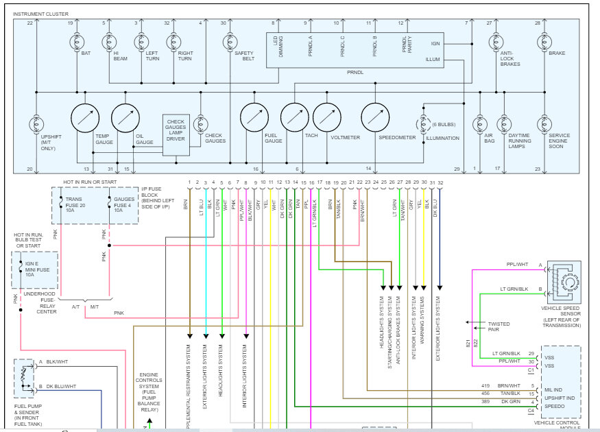

The only problem is that my gauges on the cluster are all wrong except my voltage gauge.
When I turn the key oil pressure pings to the right, when I moved the shifter the fuel gauge moves.
When headlights are turned on, the dash lights turn off.
When running the speedometer needle moves.
And tachometer only moves a little bit but is not in sync with the RPMs of the motor.
I have swapped the cluster but no change, also noticed that the wiring behind the cluster are the exact same for both vehicles.
I think I need to rewire some at the bulkhead Connection but I’m not sure as I cannot find schematics for either vehicle.

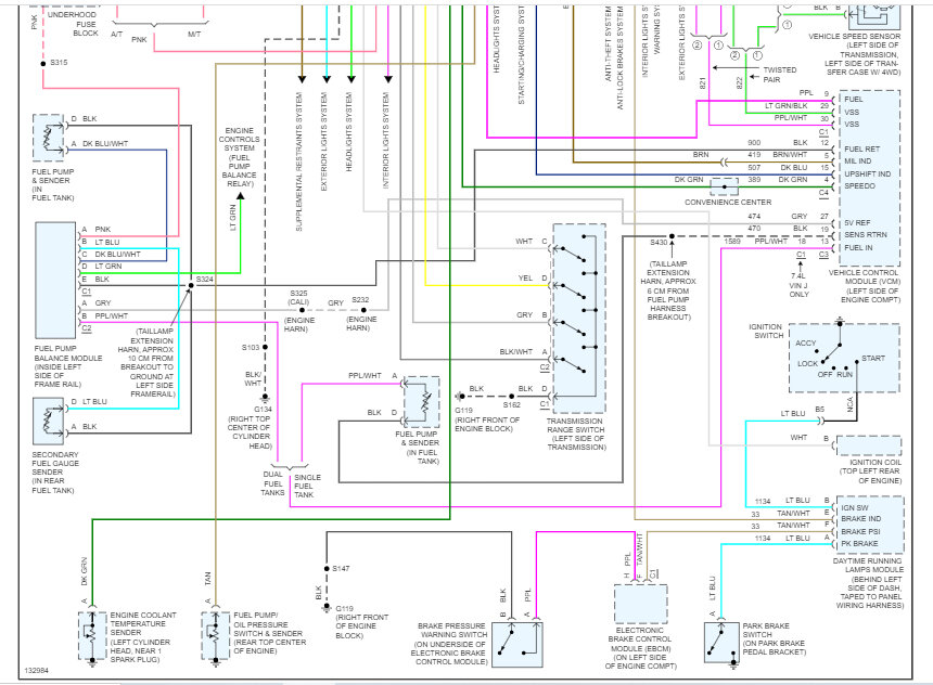

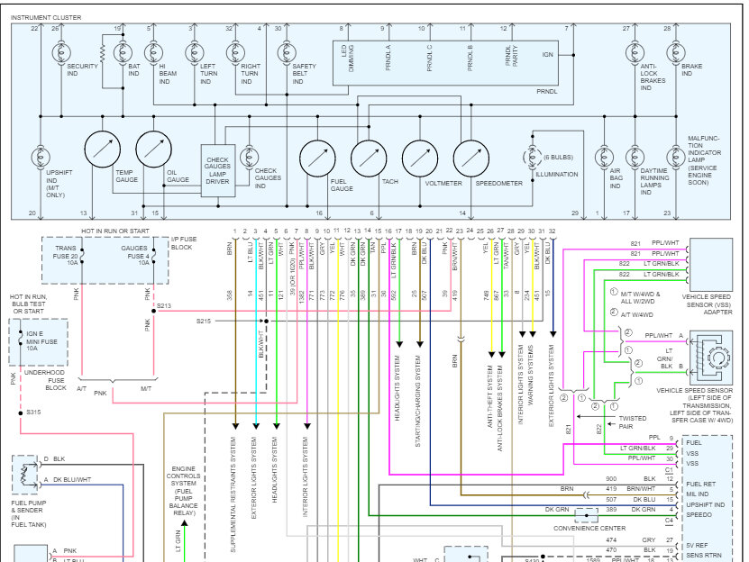

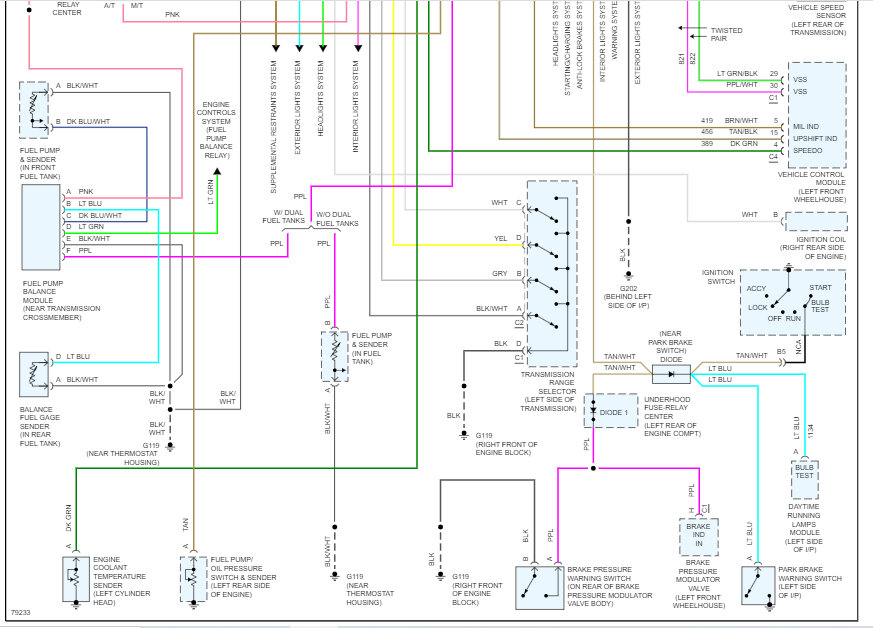

Something is different. What would be most helpful to you? I can get the power distribution schematics for both, but I suspect the wiring for the instrument cluster would be more helpful.
If you look at the first two pics below, that is for the 2000 truck, and pics 3 and 4 are for the 1996 suburban. They do look very similar.
Take a look and let me know if that helps or if you have other questions.
