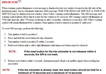

how do I reset this reminder? The dealer usually did it, but I had it serviced at a small garage close to home.

Below is info. you requested.
Hope this helps..
