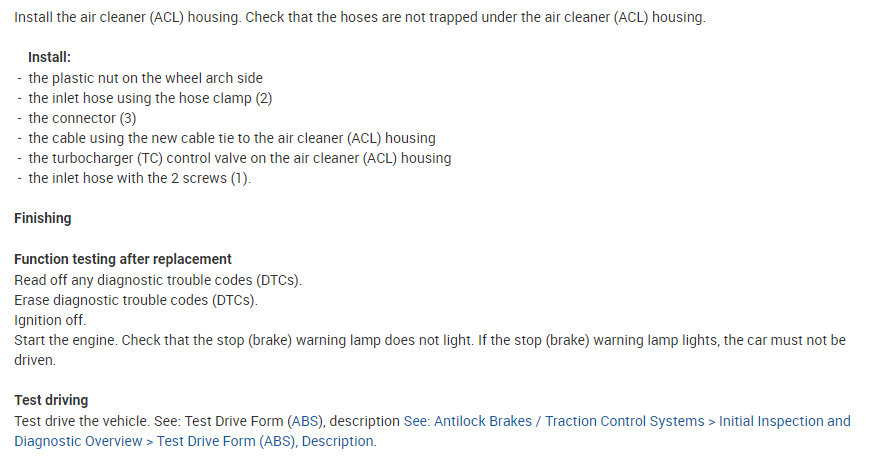

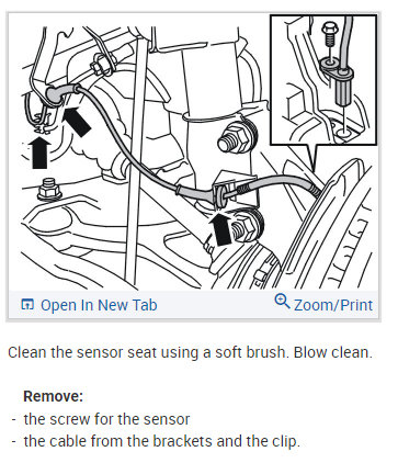

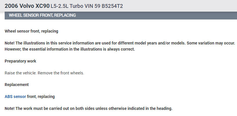

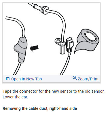

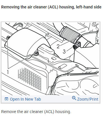

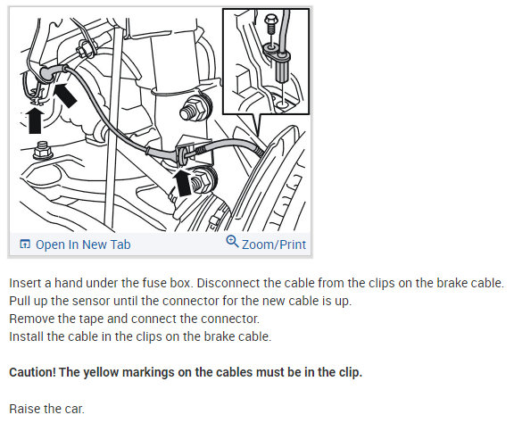

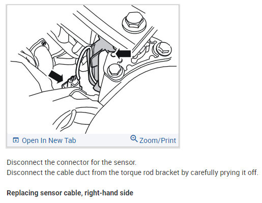

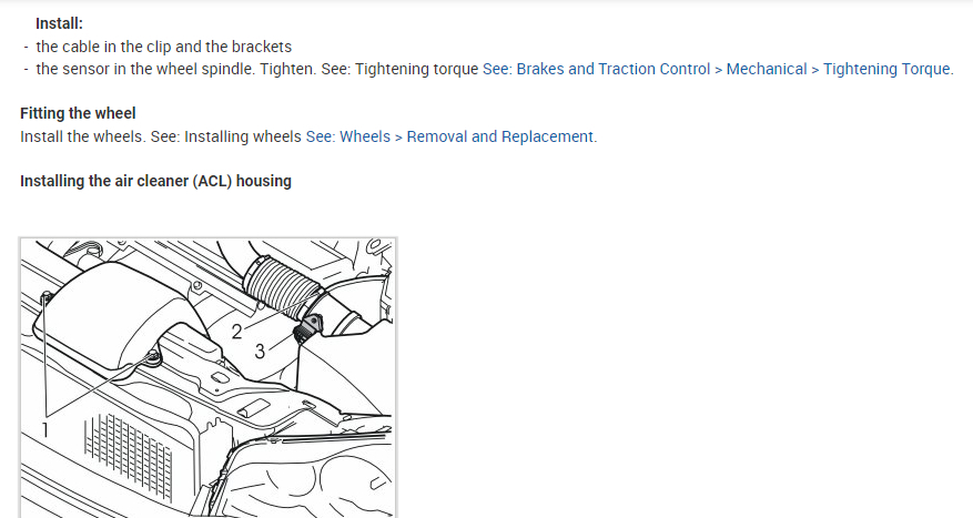

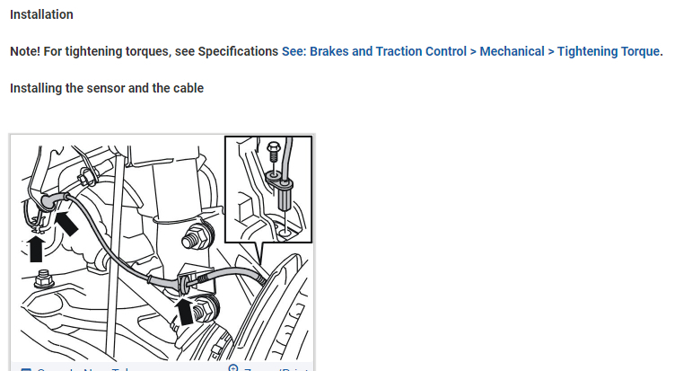

How to replace the front left wheel speed sensor?
Mar 21, 2010 at 5:20 AM
DANNY L
Experienced Mechanic
5,648 POSTS
Hello, I'm Danny.

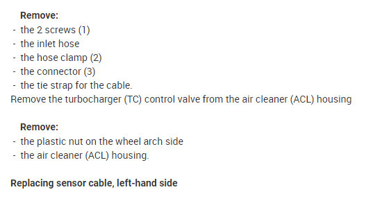

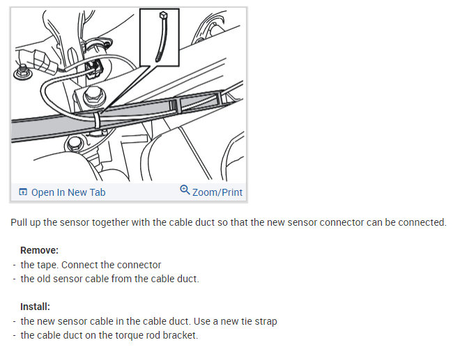

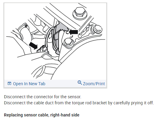

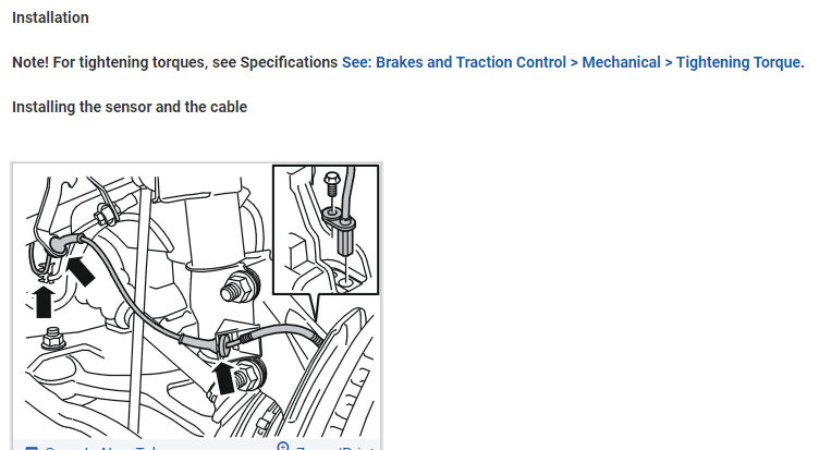

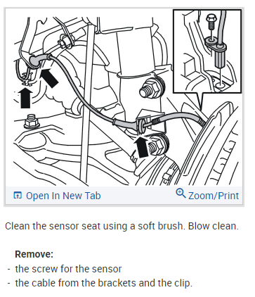

Here is the information you requested. Here is a guide to help you step by step with instructions in the diagrams below to show you how perform the repair on your car:
https://www.2carpros.com/articles/how-to-replace-an-abs-wheel-speed-sensor
I've attached picture steps below on how to change the wheel speed sensor on your car. Hope this helps and thanks for using 2CarPros.
