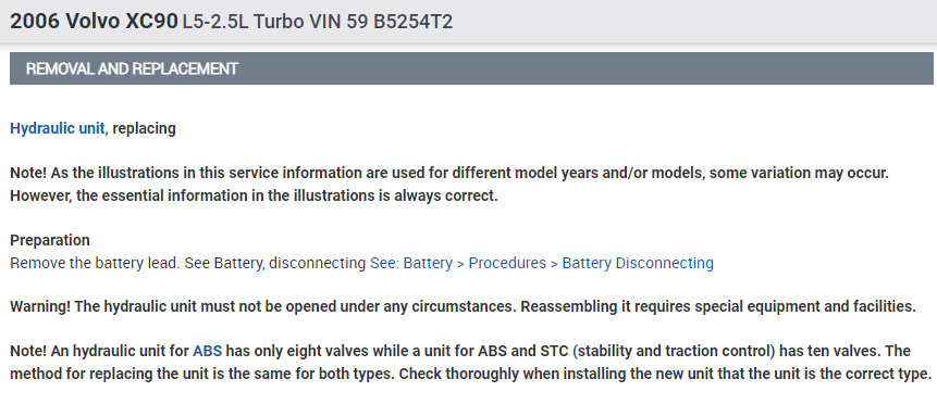

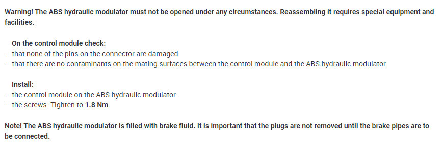

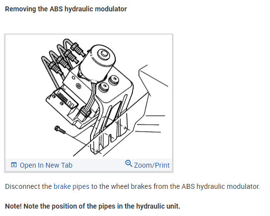

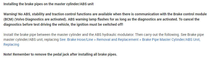

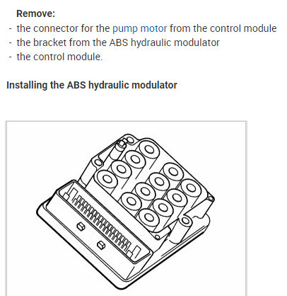

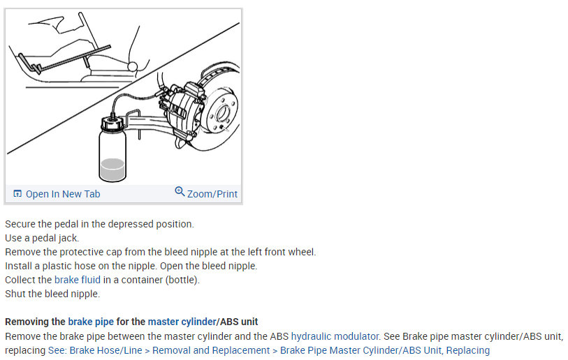

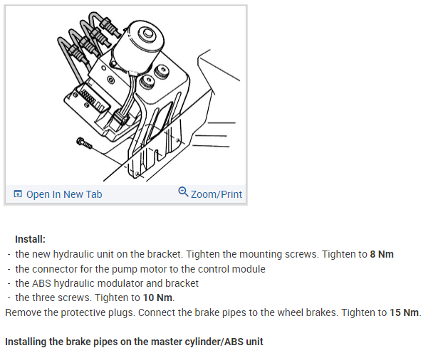

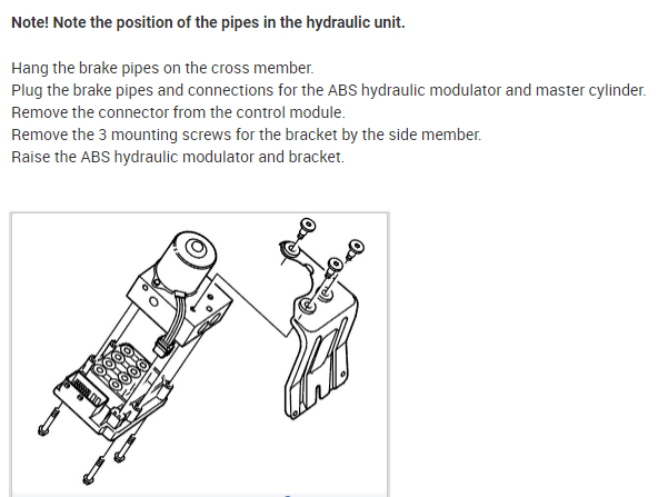

Here is the information you requested. I've attached picture steps below on how to change the ABS hydraulic unit on your car below. Hope this helps and thanks for using 2CarPros.
