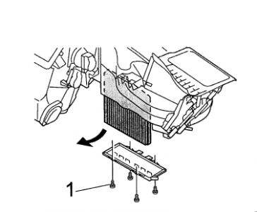

Located right side passenger compartment under soundproofing panel. Service and Repair Notes Air cleaner passenger compartment, replacing Removing the passenger compartment air cleaner (ACL)
https://images.2carpros.com/forum/automotive_pictures/248015_2_80.jpg

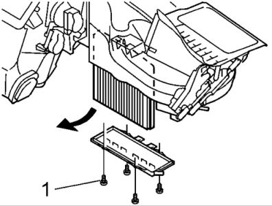

Remove: the soundproofing panel. the screws for the cover the cover. Pull the air cleaner (ACL) downwards/away. Installing the passenger compartment air cleaner (ACL)

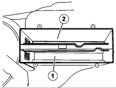

Install the air cleaner (ACL). There are 2 alternative positions for the air cleaner (ACL). See the illustration. The pollen filter (standard) must be installed in the smaller compartment (1). The multi filter (cars with an air quality sensor) must be installed in the wider compartment (2). NOTE: Install either the pollen filter or the multi filter. Both filters must not be together. Install: the screws. The front left screw must not be tightened to more than 0.8 Nm the soundproofing panel.

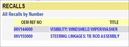

Hello - Thanks for the info JIS001 Lee Messenger - Also, it looks like you may have some recalls on your vehicle. The dealer may fix these for free. Please contact the dealer service department, give them the VIN number of your car and have them check on these to see if they apply to you.
