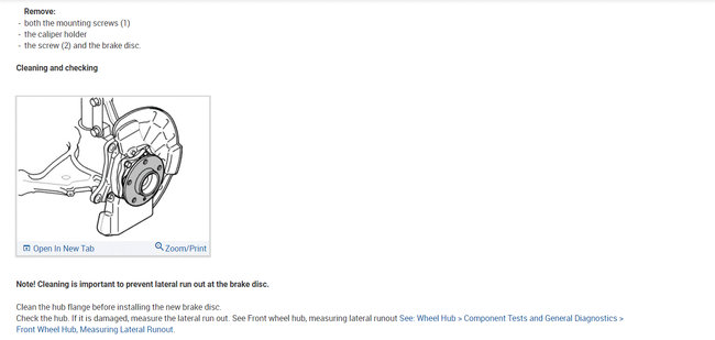

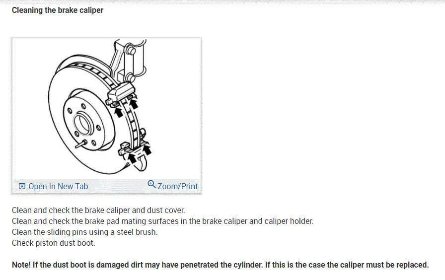

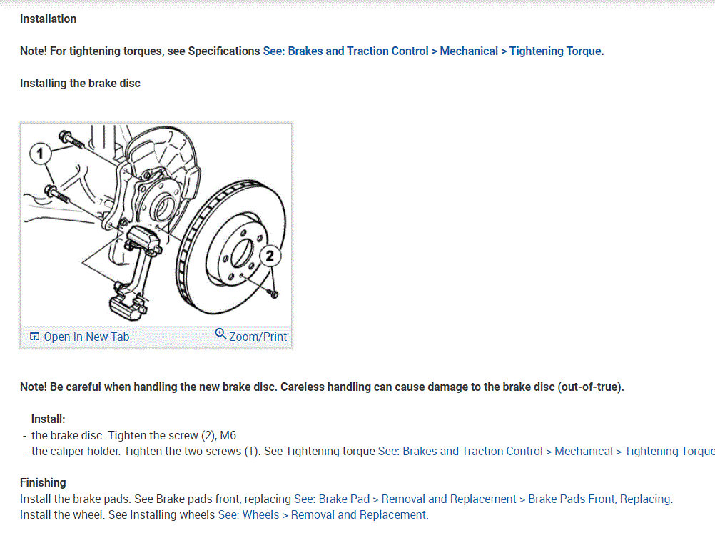

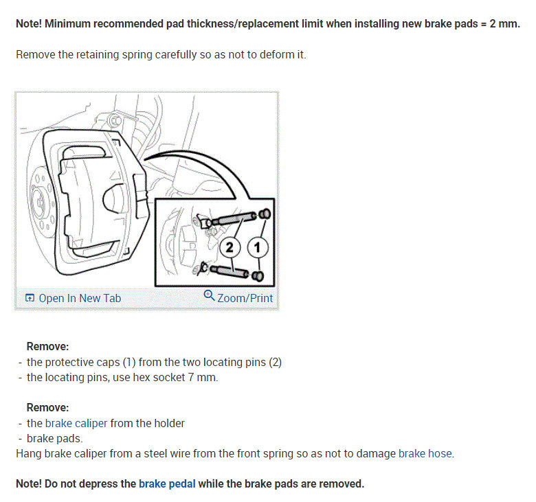

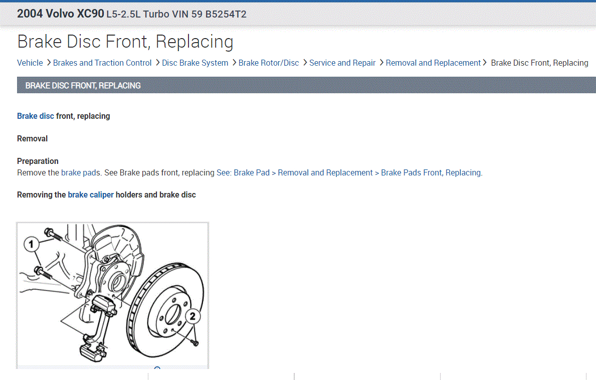

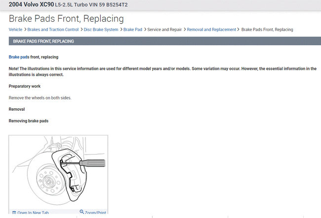

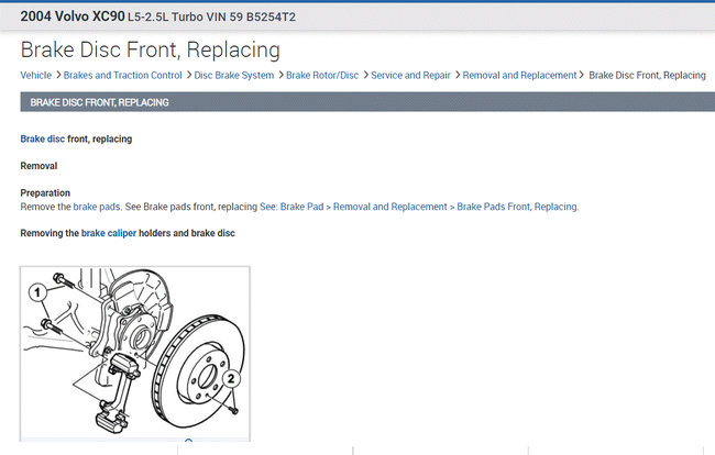

After my safety inspection they said I need new front brake can you help?
Friday, December 11th, 2009 AT 2:20 PM
  • 109,885 POSTS

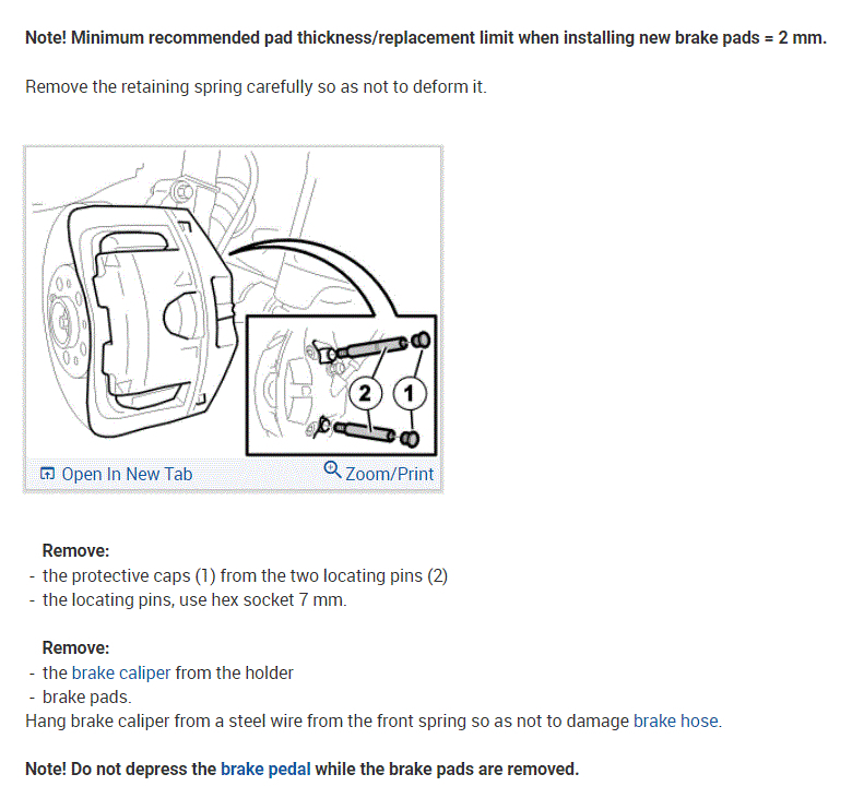

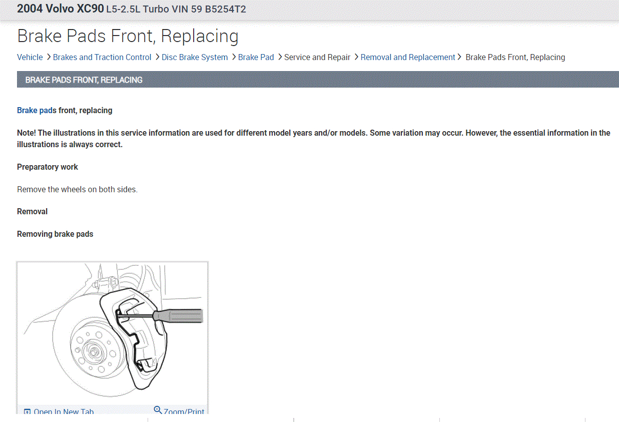

Replacing front brake pads and rotors really isn't too hard to do. If you do it yourself, make sure to get lifetime parts so you never have to pay for them again.
To get you started, here is a link that shows in general how it is done. You can use it as a guide.

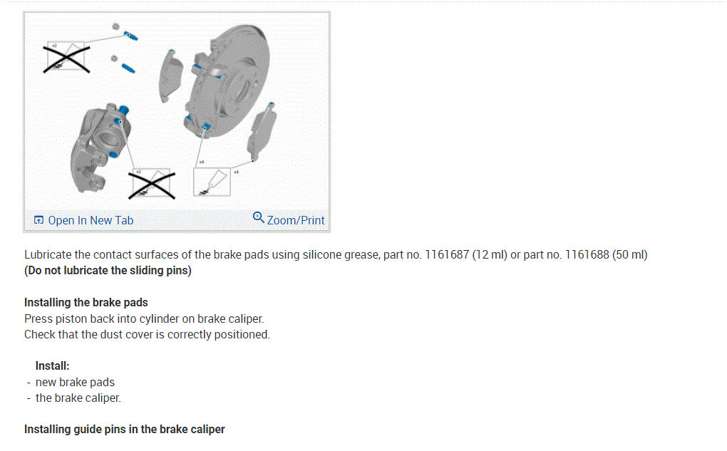

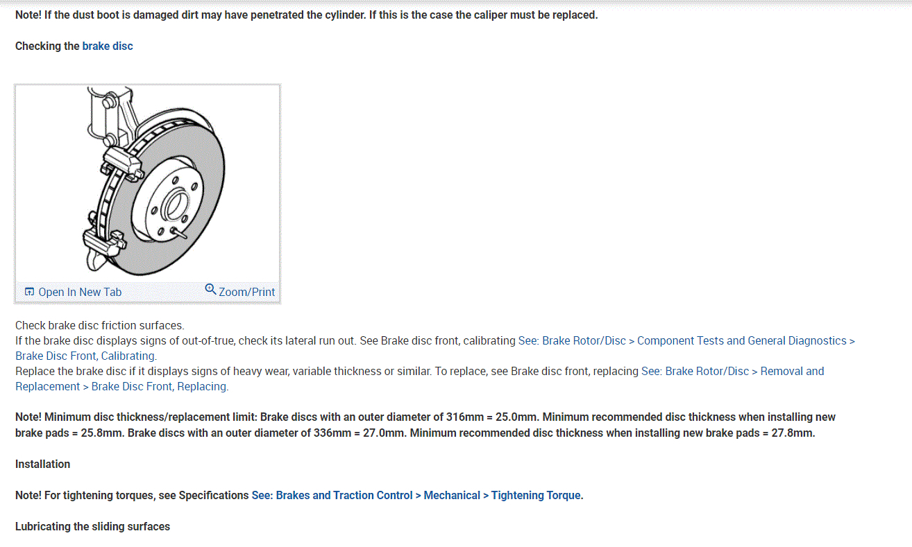

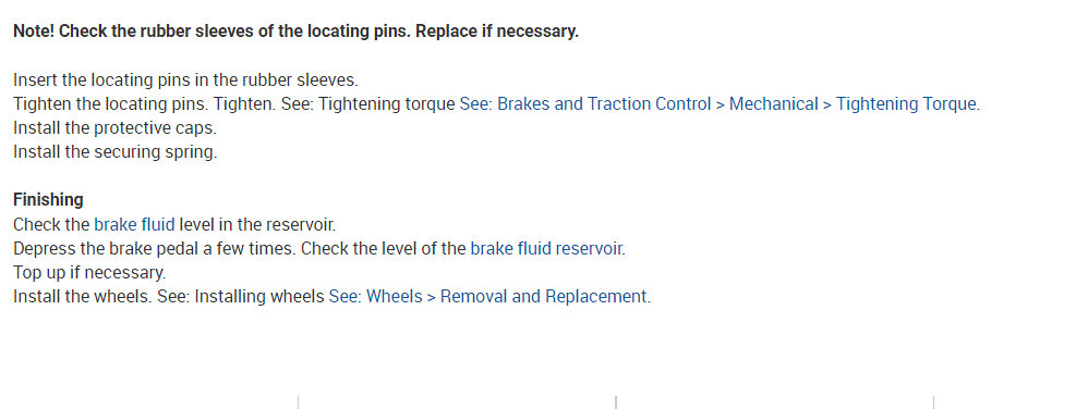

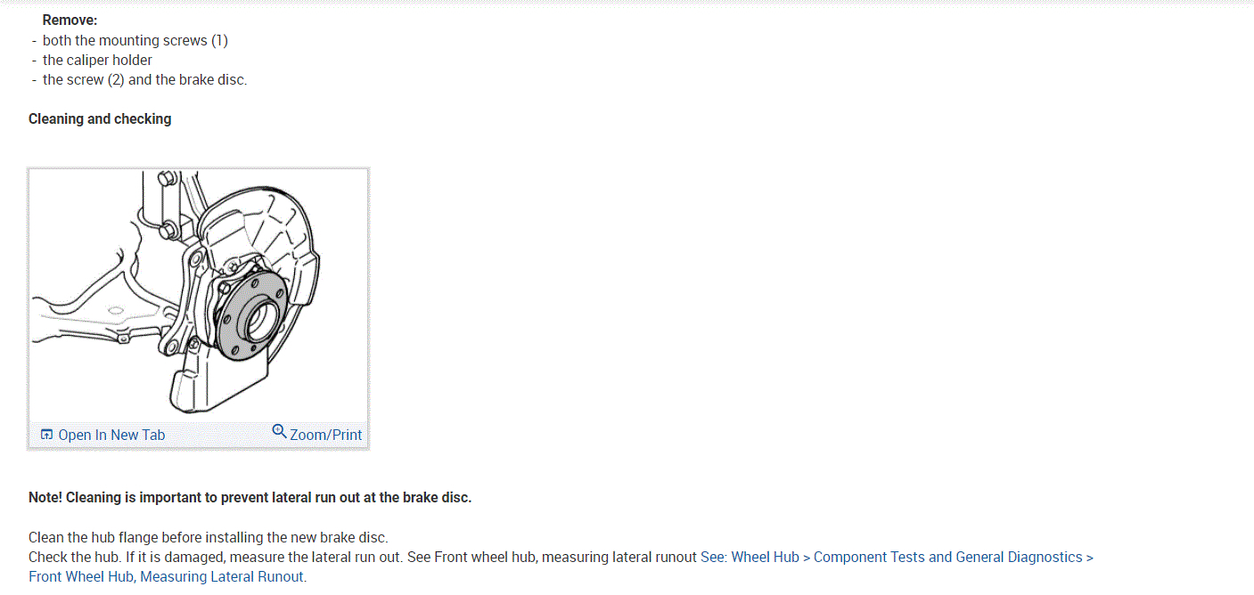

If you look at the pics below, they include the directions and pictures specific to your vehicle for this job. Follow them. If you have additional questions, let me know.
PS: See pics below for directions.
