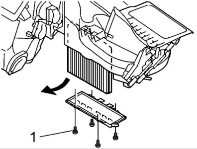

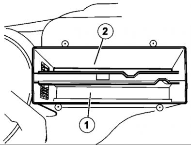

I didn't see it on the list so I was wondering how the filter is changed. I have the first cover off but I'm not sure I see the filter cover. Is it rectangular with straight sides? I might should just get ther dealer to do it. They always seem to be waiting for me to open my wwallet. Thanks

Service and Repair Air cleaner passenger compartment, replacing Removing the passenger compartment air cleaner (ACL)
https://images.2carpros.com/forum/automotive_pictures/12900_c1_45.jpg
Remove: *the soundproofing panel. *the screws for the cover *the cover. Pull the air cleaner (ACL) downwards/away. Installing the passenger compartment air cleaner (ACL)
https://images.2carpros.com/forum/automotive_pictures/12900_c2_37.jpg
Install the air cleaner (ACL). There are 2 alternative positions for the air cleaner (ACL). See the illustration. The pollen filter (standard) must be installed in the smaller compartment (1). The multi filter (cars with an air quality sensor) must be installed in the wider compartment (2). NOTE: Install either the pollen filter or the multi filter. Both filters must not be together. Install: *the screws. The front left screw must not be tightened to more than 0.8 Nm *the soundproofing panel. https://www.2carpros.com/kpages/auto_repair_manuals_alldata.htm
