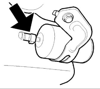

Cud u please tell me the location of the fuel filter and also how to reset the service light.

Some do not have serviceable fuel filters. If you do have one, it is located under the rear passeger side towards the front of the rear wheel.
https://images.2carpros.com/forum/automotive_pictures/337695_112069579_1.jpg
To reset service light. Turn key to position one. Hold the trip button in. While holding, turn key to position two. Keep holding trip button until the triangle flashes. Then your done. If it does not reset, try it again. Sometimes I dont get it the first time either ;)
