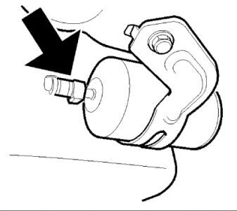

Cud u please tell me the location of the fuel filter and also how to reset the service light.

Some do not have serviceable fuel filters. If you do have one, it is located under the rear passeger side towards the front of the rear wheel.
https://images.2carpros.com/forum/automotive_pictures/337695_112069579_1.jpg
