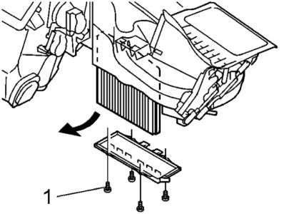

How do I replace air cabin filter? What are the steps?

The filter is on the pssenger side. Remove the sound proof panel under the glovebox. two screws hold this panel. Once you have removed it, you will see the climate box. Under the box is the door for the cabin air filter. It is held by 4 screws. Remove the screws to remove the panel. Slide filter out downwards.
https://images.2carpros.com/forum/automotive_pictures/337695_112069587_1.jpg
Reverse order to install. Hope this helps.
