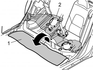

Is there an acccess pannel to allow replacing the pump without droping the gas tank?

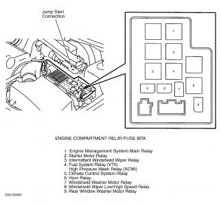

Is there a fuel pump relay in this model?
Aug 10, 2010 at 11:07 AM
DOCFIXIT
  • 18,828 POSTS
Yes to both see diagrams
https://images.2carpros.com/forum/automotive_pictures/198357_Grafic_3_138.jpg
https://images.2carpros.com/forum/automotive_pictures/198357_Graphic_1_2.jpg
