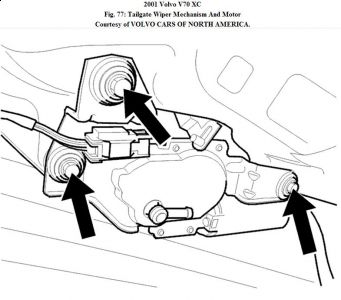

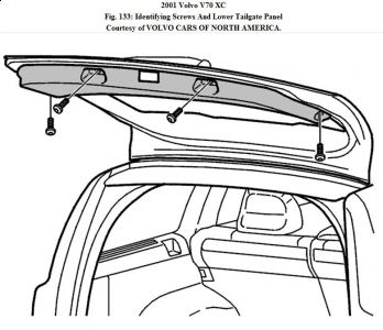

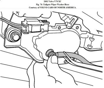

How do you access and remove the rear hatch wiper motor?

Hi fezzik414, Thank you for the donation. Here are the procedures for replacing the tailgate wiper motor. MOTOR, TAILGATE WIPER, REPLACING Removal "¢ Remove the rear windshield wiper arm. See Tailgate wiper arm/blade, replacing "¢ Remove the tailgate panel. See Lower tailgate panel . "¢ Press the mounting for the washer hose towards the motor.
https://images.2carpros.com/forum/automotive_pictures/192750_WiperWasherHose01V70XCFig76_1.jpg
"¢ Remove the washer hose "¢ Disconnect the connector "¢ Remove the screws.
https://images.2carpros.com/forum/automotive_pictures/192750_WiperMotorRear01V70XC_1.jpg
"¢ Remove the mechanism and motor. Installation "¢ In reverse order. Lower Tailgate Panel Removing the rear door panel "¢ Remove 2 screws on each side "¢ Begin by detaching the panel at the window (eight covered clips in total).
https://images.2carpros.com/forum/automotive_pictures/192750_TailgatePanel01V70XCFig133_1.jpg
NOTE: When removing, note the position of the screws (the screws are two different lengths). Removing the rear door panel Installing the rear door panel Install: In reverse order. NOTE: Ensure that the guide pins are correctly position before pushing the panel into place. NOTE: Ensure that the clips click when they are pressed into place.
