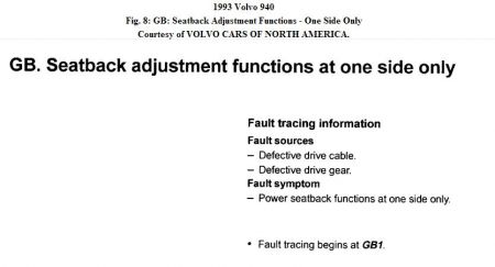

Driver seat power adjustment moves only on one side, not both. Is this simple to fix?

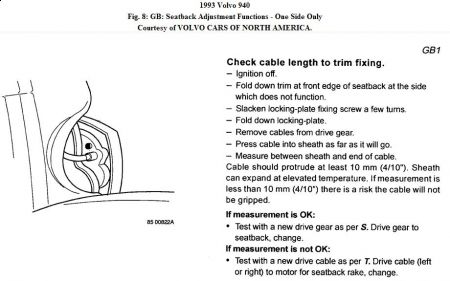

Hi rogerdyar11, Here are the diagnostic procedures.
https://images.2carpros.com/forum/automotive_pictures/192750_SeatAdjust93Volvo01a_1.jpg
https://images.2carpros.com/forum/automotive_pictures/192750_SeatAdjust93Volvo01b_1.jpg
