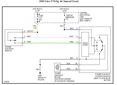

2000 Volvo V70 sunroof will not open
2000 VOLVO V70
VELOX
Electrical problem
2000 Volvo V70 Automatic 135800 miles
i have tried a few things with no luck, i have checked all fuses including fuse 35, 37 with light tester, i have locked and unlocked from outside drivers side 4-5 times to reset, i have disconnected the battery for 15 min., have checked the button relay there is power because i hear a clicking sound but still will not open, any suggestions?
May 12, 2009 at 1:57 PM
KHLOW2008
  • 41,814 POSTS
Hi velox, Our database does not have any diagnostic procedures and the only thing I can help is provide you with a wiring schematic.
https://images.2carpros.com/forum/automotive_pictures/192750_Sunroof00volvoV70_1.jpg
Disconnect motor and test if it works.
