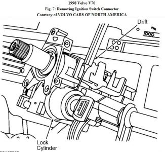

Hi Rich, Lucky thing the key can still be turned to the " I " position, that would make it easy to remove the lock assy. A locksmith should be able to do the repair for you. Once the lock is out, use a screwdriver to turn the internal part of steering lock to test if you can start vehicle. Removing the lock would make it easier to rectify any problem. Debris could have gotten into the cylinder and compressed air might help. DO NOT use anything to force the key tumblers, that might damage the key cylinder beyond repair. The key is not equipped with transponder and no programming is required with lock change. Here are the removal procedures for the lock cylinder. LOCK CYLINDER Removal Disconnect negative battery cable. Lower steering wheel adjusting lever and pull steering wheel to highest position. Remove upper and lower steering column covers. Insert ignition key into lock. Turn key to "I" position. Using a .079" (2-mm) drift, press lock cylinder lock lug down. Remove lock cylinder. NOTE : Take care not to lose the small joint behind key cylinder( if equipped )
https://images.2carpros.com/forum/automotive_pictures/192750_KeyCylinder98VolvoV70_1.jpg
Installation Insert key into new lock cylinder. Turn key to "I" position. Using a .079" (2-mm) drift, press lock lug down. Install ignition lock. Install upper and lower steering column covers. Ensure no wires are pinched when covers are installed. To complete installation, reverse removal procedure.

Unable to find 'lock cylinder lock lug' ! There are no holes evident to insert the drift into!
Have found other info that indicates we may need to remove the entire assembly (cylinder, ignition switch, and the column lock), which is assembled together.

The link that you provided stated it is for 99 upwards whereas yours is 98 so it should be different. However we cannnot discount the possibility that your model is not equipped with it.
If you lock assy looks like the one indicated, then it applies.
The lock lug is at top of cylinder housing where you would find a bridge like section.
If you need to remove the lock assy, at the part where a drill is used, you can use a center punch and a small hammer to tap the bolt loose. It usually works. When tapping, use light force, just enough to vibrate it loose. Excessive force would cause the bolt to stick and also shear the bolt making it more difficult to loosen as the punch is unable to hold position.
