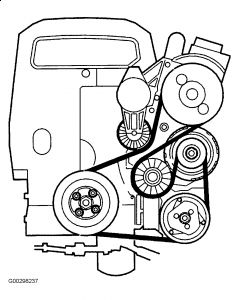

How do you replace a belt on a 1998 S90 volvo? Having difficulty because it seems too tight. Any suggestions?

Need to place a 3/8 in ratchet in square hole in tenisoner. rotate away from belt as it slackens remove from pullies.
