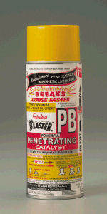

Once the hub bolts and caliper are removed, the only thing holding the rotor to the hub is rust. No, WD40 won't do, you need some rust catalyst such as PB Blaster, available at your local auto parts store. Using the straw (should come with the can), spray through the hub holes (all of them), and if you have access, from the back as well. Wait about 5 minutes, and then use a rubber mallet to break the rotor free.
https://images.2carpros.com/forum/automotive_pictures/55316_16pb_6.jpg

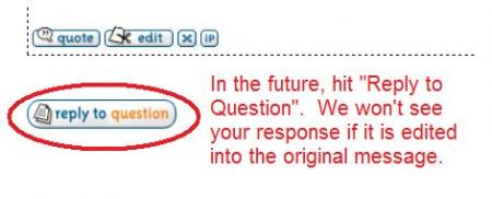

https://images.2carpros.com/forum/automotive_pictures/55316_howtoreply_1.jpg
Here is the reason for the delay is response. Anyway. You may want to remove the wheel on the driver side, and see how the caliper and pads on that side are installed. The passenger side should be the mirror image of the driver side.
