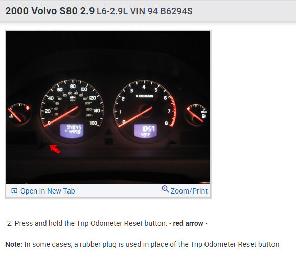

...my s80 2000 volvo stc service light came on. how can i fix this problem ?...and what it cause that problem
Mar 17, 2010 at 5:41 PM
SQM
  • CAR REPAIR CONTRIBUTOR
  • 6,383 POSTS

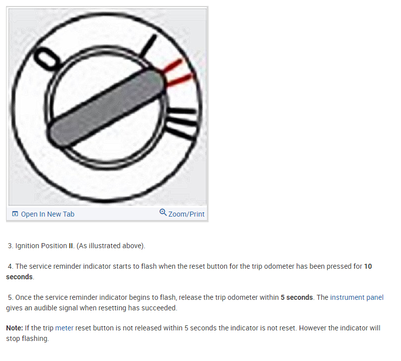

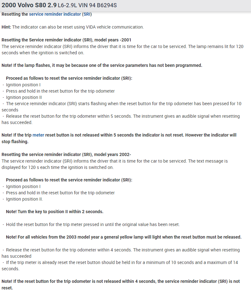

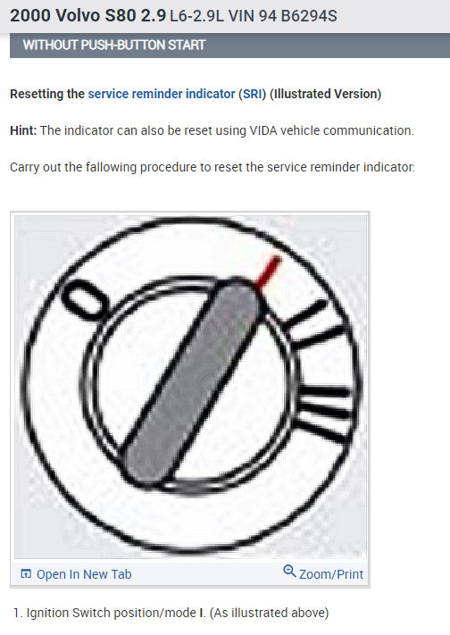

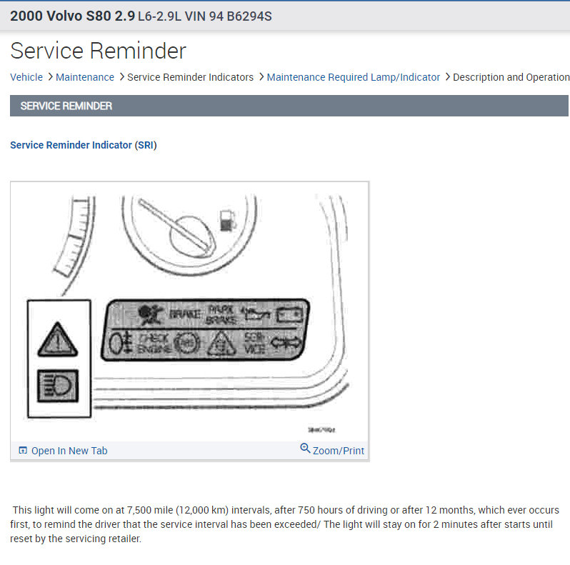

The service light is designed to come on at every 7,500 miles (12,000 km) intervals or after 750 hour of driving or after 12 months. Whichever occurs first.
It is a reminder to do oil changes and other factory recommended services for that given mileage.
This light has to be reset. Without the reset it will stay on.
https://www.2carpros.com/articles/oil-life-reset
I have attached the reset procedure for your reference.
