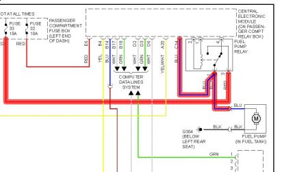

Where is the fuel pump inertia shut-off switch located on this vehicle?

When you turn key to run do you hear the fuel pump come on in the fuel tank?? If not could be a fuse or fuel pump relay

Checked the fuses. Don't know where the fuel pump relay is. Parts stores told me they cannot even ORDER the repair manual for this car. I am totally frustrated! Thanks for trying. nwflymom@yahoo.com

I do think I hear the fuel pump come on, too.

Check fuse no.33 15amp in the passenger compartment fuse box left end of dash and the fuel pump relay is the engine comaprtment relay box.
https://images.2carpros.com/forum/automotive_pictures/12900_fp_volvo_1.jpg
