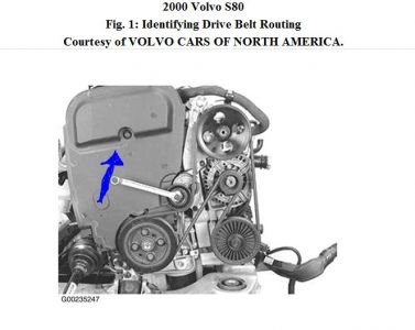

How do change the serpentine belt on 2000 Volvo S80

Attach spanner and lift up to take pressure off belt for removal, see pic.
