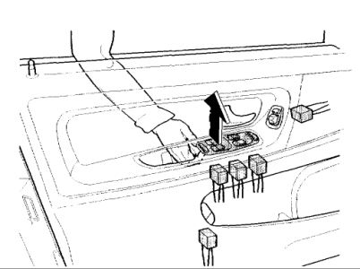

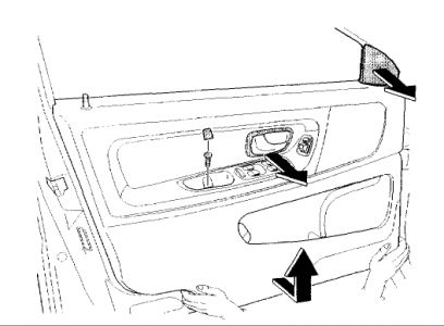

How to take off the panel and replace the switches. All are 10 years and the rubber switches are sticky. How is the best process to take off the panel.

If you are going to replace the window switch then I would recommend you get some sorte of hook and insert it around one of the switch buttons and yank up. Saves you the trouble of removing the door panel. But if you do want to remove the panel then here is the procedure............. Remove: 1 Torx 20 screw. panel trim around door handle. door mirror panel. Remove 7 clips on the bottom of the door.
https://images.2carpros.com/forum/automotive_pictures/337695_79139542_2.jpg
Once you have the panel off push up on the switch.
https://images.2carpros.com/forum/automotive_pictures/337695_79139543_1.jpg
Good luck.
