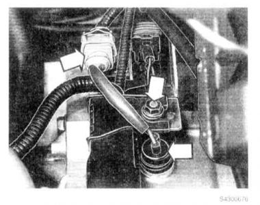

My speedometer works on and off, changed out the instrument cluster, still only works once in while. I think it may be vehicle speed senor (VSS) somewhere in transaxle. Please send me a good diagram/picture and other identifing items of the location of this sensor.Matt, from your outfit sent me a picture that I can't make-out. Thanks

Hi Colebruce,Welcome to 2carpros and TY for the donation. See diagram below:
https://images.2carpros.com/forum/automotive_pictures/12900_vss_31.jpg

I have the same exact problem and replaced the vss with a oem sensor. I am still having the same problem. What else can possibly be wrong?

Could be an another one on the speedometer assy if not test the wiring if okay think computer

i also failed to mention that i have an abs problem too. can this be related? my traction control light is on and the abs light. otherwise everthing else on the car runs great. i have 180,000 miles on it and it will still crack 130mph like a cheetah. lol
