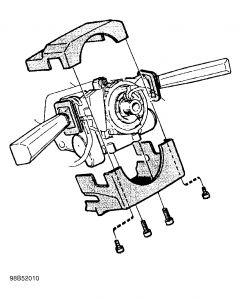

Hello .. thanks for the donation .. much appreciated Hope this helps .. let me know PROGRAMMING REMOTE CONTROLS Ensure all doors, hood, and trunk are closed. Turn ignition on and off at least 5 times in 10 seconds. Indicator LED should start to flash. Leave ignition on. Once indicator LED starts flashing, first remote control must be programmed within 15 seconds. Press button on first remote control. Programming is acknowledged by indicator LED lighting for about 2 seconds. Indicator LED will then start flashing for 10 seconds. Program second remote control within 10 seconds while indicator LED is flashing. Turn ignition off. Test remote controls. Up to 3 separate remote controls can be programmed for vehicle. SERVICE CAMPAIGN 83 - IGNITION SWITCH REPLACEMENT TECHNICAL SERVICE BULLETIN Reference Number(s): GROUP 33, NO. 0002 Related Ref Number(s): GROUP 33, NO. 0002 ARTICLE BEGINNING SERVICE CAMPAIGN NO: 83 D, STARTER/IGNITION SWITCH, REPLACEMENT Model(s): 1998 Volvo S70, V70 Section: 3 - Electrical Systems & Instruments Group: 33 - Starter Motor Bulletin No.: 0002 Date: May 1998 REFERENCE TP6001201, Section 6,7(60-64, 70-77) Front end, steering 850 1992- PART REQUIRED PARTS INFORMATION Description Part Number Qty. Starter switch94478041 STARTER/IGNITION SWITCH, REPLACEMENT Remove Disconnect the negative battery cable. NOTE:The steering wheel does not have to be removed to replace the starter switch. Release the lock for the tilt/telescope adjustment and pull the steering wheel toward the rear of the vehicle and lock the wheel in this position. Remove the steering column covers. See Fig. 1 . REMOVING ELECTRICAL COMPONENTS Carefully separate the connector from the starter switch. Remove the two screws that holds the starter switch to the ignition lock. Carefully remove the starter switch from the ignition lock. INSTALLING IGNITION SWITCH Before installing the starter switch; make sure that the center key hole in the starter switch is properly aligned with its corresponding dowl key in the ignition lock. Reconnect the wiring connector to the ignition switch. REINSTALLING PANEL AND STEERING WHEEL COVERS CAUTION:Route the wire harness for the starter switch so that no chafing and/or pinching can occur when reinstalling the steering column covers. Reinstall column covers. Reconnect battery. Set radio code. Fig. 1: Removing/Installing Steering Column Covers
https://images.2carpros.com/forum/automotive_pictures/266999_volvo_1.jpg

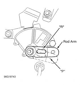

ADJUSTMENTS GEARSHIFT CABLE Shift gear selector lever to Reverse. Disconnect gearshift cable at transmission rod arm. Move transmission rod arm forward to "P" position. See Fig. 1 . NOTE:DO NOT move transmission cable to adjust selector lever position. Transmission cable position must not be altered. Ensure vehicle is in Park by attempting to roll vehicle. Move transmission rod arm to "R" (next position). Apply a small amount of grease to rod arm pin. Carefully reinstall cable on transmission rod arm. Ensure gear selector does not move during installation. Move gear selector lever to Neutral. Push lever forward, but DO NOT touch lock button. Play should be felt. Move gear selector lever to Drive. Push selector lever backward, but DO NOT touch lock button. Play should be felt. Fig. 1: Adjusting Rod Arm
https://images.2carpros.com/forum/automotive_pictures/266999_volvo_2.jpg
