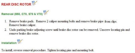

how many bolts are removed in order to take off the rear rotors

https://images.2carpros.com/forum/automotive_pictures/261618_Noname_894.jpg
