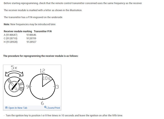

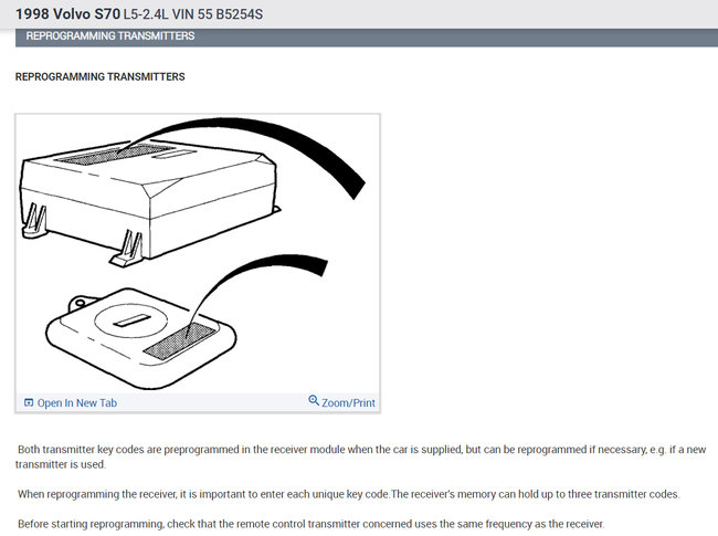

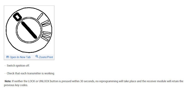

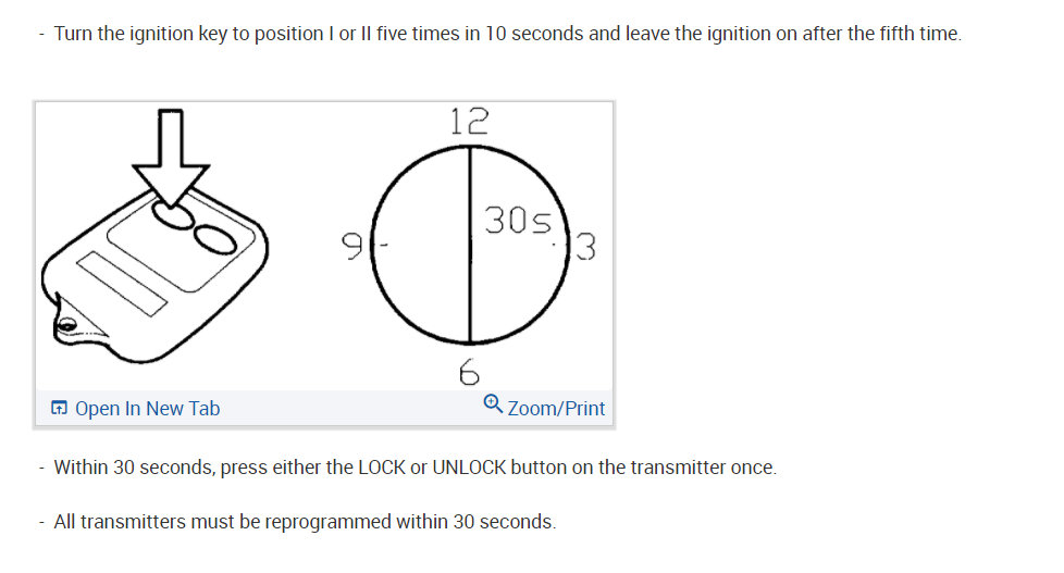

Actually you can do it yourself here are the instructions in the diagrams below to help reprogram your key fob. Check out the diagrams (Below). Please let us know if you need anything else to get the problem fixed.
