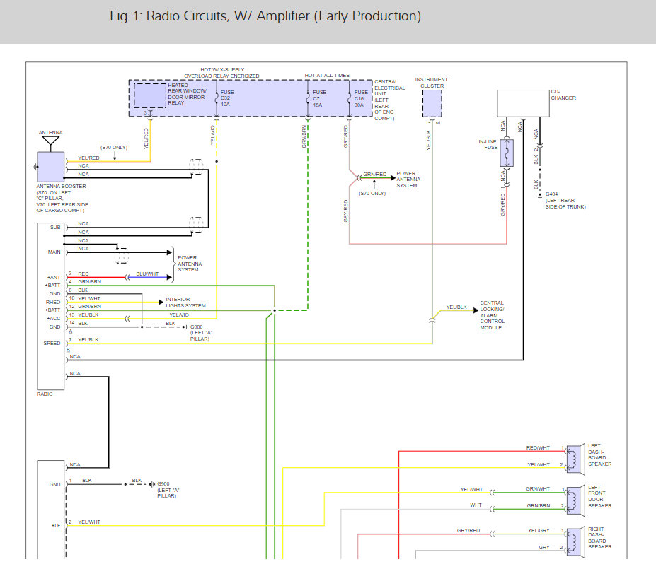

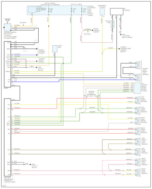

Hello, I have spent two hours online looking for a wiring diagram for a 98 volvo s70, so that I can install my New Stereo. Thought I had the right one but all the colors were wrong, Need to know Speakers + and -, battery 12v, and 12v dc, also ACC, ILL, and thats all, Thank you.

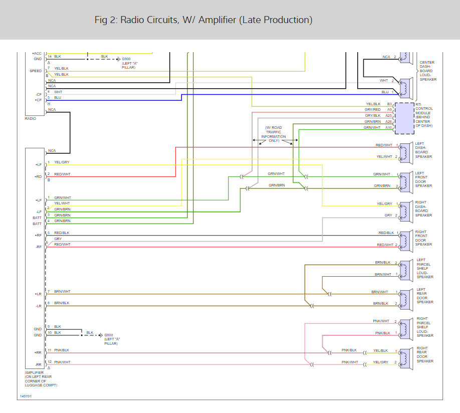

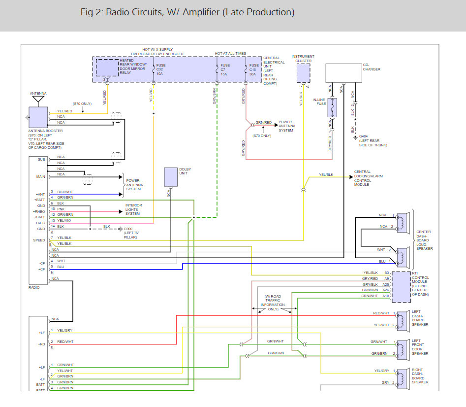

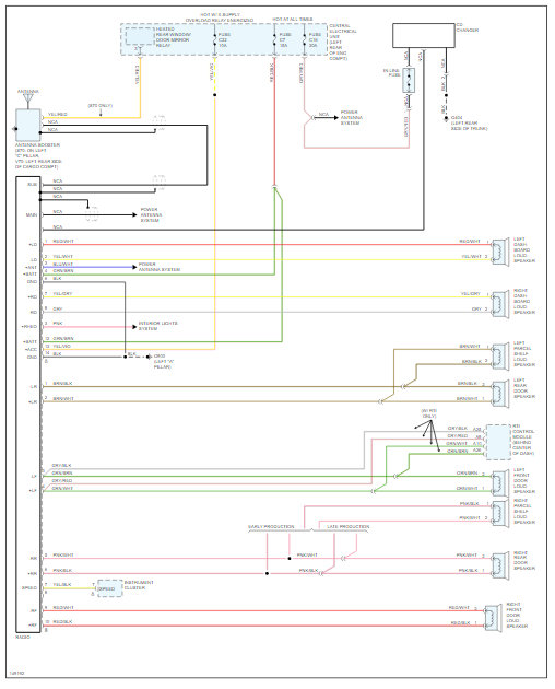

Hope this is the correct diagram there is an early and late production model here are the wiring diagrams for both. Check out the diagrams (Below). Please let us know if you need anything else to get the problem fixed.

You can also try to buy an oem wiring kit for your make and model vehicle. You just splice in the connector to your new radio and plugs into your factory connector. You can look online like Best Buy or some where that installs radios.

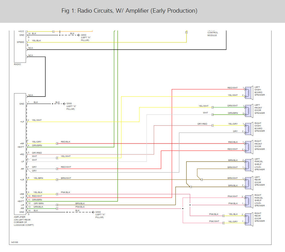

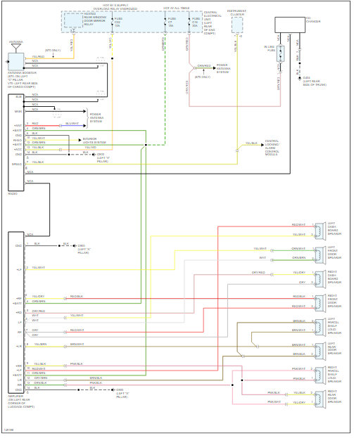

I've attached three pictures of the stereo wiring diagrams. Here is a tutorial showing how to check wiring:
The picture #1 is early production with amplifier, #2 is late production with amplifier, and #3 is radio without amplifier. Hope this helps and thanks for using 2CarPros.
