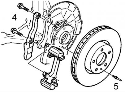

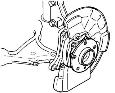

how do i change front disks?

Replacing Front Brake Discs Removal Remove the securing spring and locating pins Remove the brake caliper and brake pads Remove the caliper holder and the brake disc Remove:
https://images.2carpros.com/forum/automotive_pictures/12900_b1_17.jpg
*both the mounting screws (4) for the caliper holder. Remove the holder *the locating pin (5) and the brake disc. Cleaning and inspection
https://images.2carpros.com/forum/automotive_pictures/12900_b2_17.jpg
NOTE: Cleaning is important to prevent lateral runout at the brake disc. Clean the hub flange before installing the new brake disc. Check the hub. If it is damaged, measure the lateral runout. Installation Install the brake disc NOTE: Be careful when handling the new brake disc. Careless handling can cause damage to the brake disc (out-of-true). Install:
*the new brake disc. Tighten the locating pin (5). Tighten to 8 Nm *the caliper holder. Use new mounting screws (4). Tighten to 100 Nm . Install the brake pads and brake caliper Install the locating pins in the brake caliper Install the wheel. https://www.2carpros.com/kpages/auto_repair_manuals_alldata.htm
