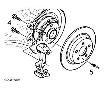

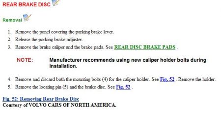

how to remove rear rotors on a 2001 volvo s60 turbo charged 2 wheel drive
Nov 10, 2008 at 4:40 PM
MHPAUTOS
  • 31,937 POSTS
Hi there, Remove rotors as per pic & text. Mark (mhpautos)
