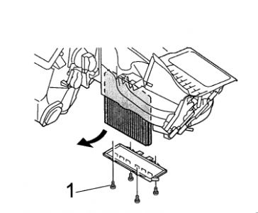

Where is the cabin air filter located and how do you replace it?

Located right side passenger compartment under soundproofing panel. Air Cleaner Passenger Compartment, Replacing NOTE: The illustrations in this service information are used for different model years and / or models. Some variation may occur. However, the essential information in the illustrations is always correct. Removal Remove: the soundproofing panel. Remove:
https://images.2carpros.com/forum/automotive_pictures/12900_c_10.jpg
the screws for the cover the cover. Pull the air cleaner (ACL) downwards / away. Installation

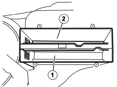

Install the air cleaner (ACL). There are 2 alternative positions for the air cleaner (ACL). See the illustration. The pollen filter (standard) must be installed in the smaller compartment (1). The multi filter (cars with an air quality sensor) must be installed in the wider compartment (2). NOTE: Install either the pollen filter or the multi filter. Both filters must not be together. Install: the screws. The front left screw must not be tightened to more than 0.8 Nm the soundproofing panel. https://www.2carpros.com/kpages/auto_repair_manuals_alldata.htm
