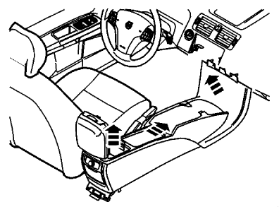

I'm trying to remove the center console and replacing a new one.

Remove the panel inside the center console. It is secured with 4 hidden clips
https://www.2carpros.com/forum/automotive_pictures/337695_140617542_1.gif
the center console.

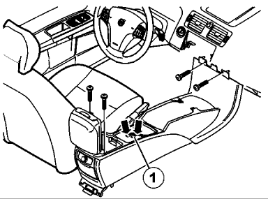

the 2 connectors.
the panel under the cover / armrest
the 4 screws
the 2 connectors (1).
https://www.2carpros.com/forum/automotive_pictures/337695_140617543_1.gif
Lift the rear edge of the center console. Then lift the center console forwards / upwards.

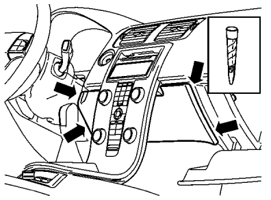

Transferring components
Transferring components center console
Transfer:
the cup holder.
the rear cigarette lighter socket.
the cover / armrest.
Cover/armrest tunnel compartment the front storage compartment.
https://www.2carpros.com/forum/automotive_pictures/337695_140617544_1.gif
