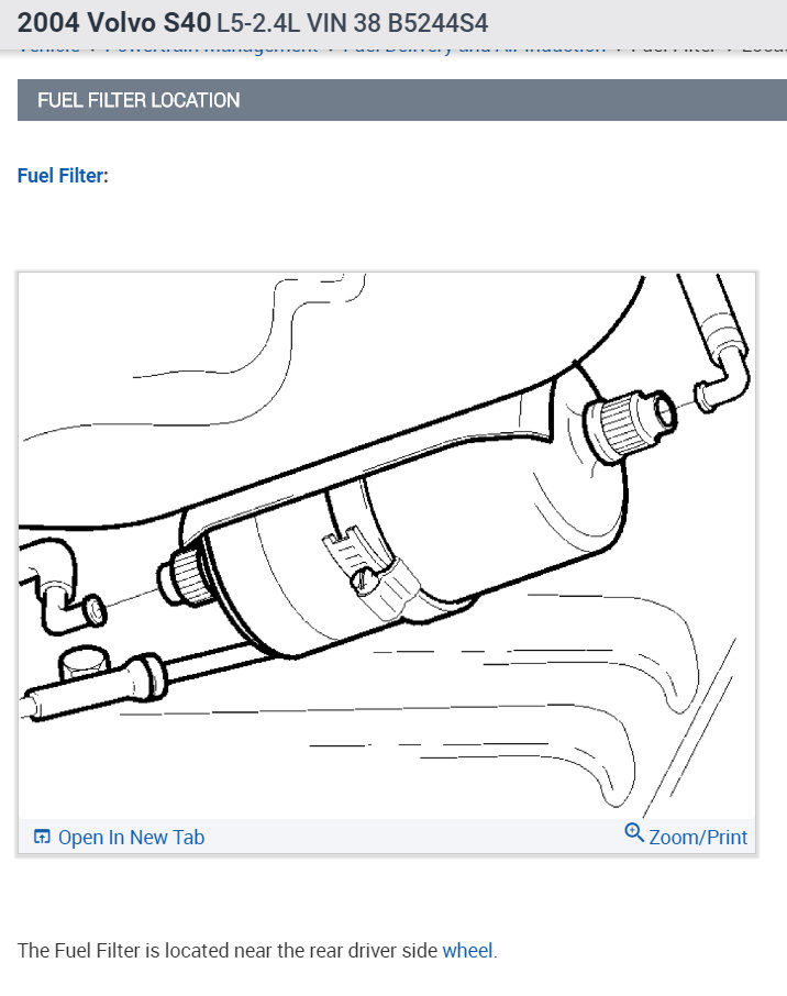

where is the fuel filter located?
2004 VOLVO S40
RAMSEY MARTINUS
i would like to know where is the fuel filter located?
Dec 4, 2009 at 11:14 PM
JIS001
  • 3,412 POSTS

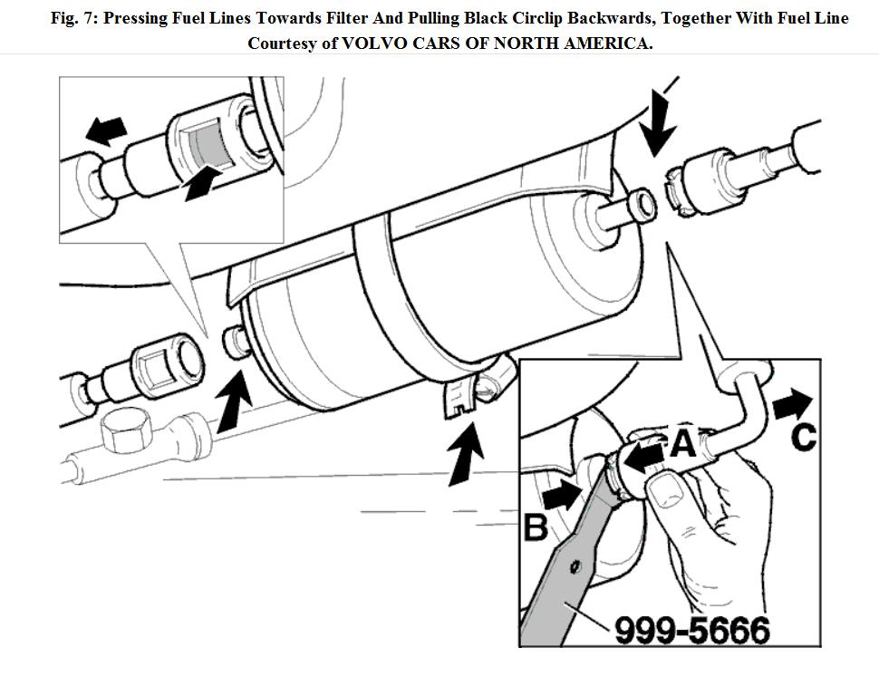

The filter is located by the drivers side rear wheel. This guide will help walk you thought he job with a diagrams below to show you the location on our car.
https://www.2carpros.com/articles/how-to-change-a-fuel-filter
Check out the diagrams (Below) Please let us know if you need anything else to get the problem fixed. Cheers

by the fuel tank
Compress the clip. Pull out the fuel line.
you may need a special tool if you have a 544 body filter is in tank.
