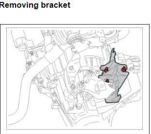

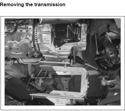

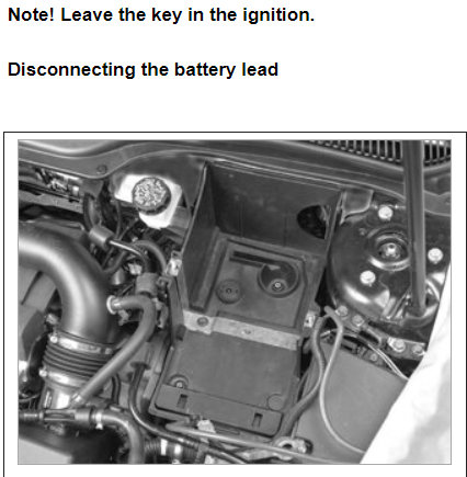

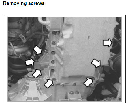

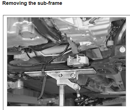

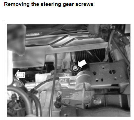

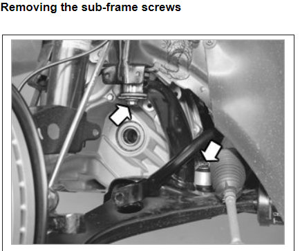

Transmission problem Manual 42000 miles
In the past 24 hours it has become very difficult to change gears. At the end of the journey i could not put the car in reverse gear? Is is gear lever bushes worn, teeth of linkage damaged or something more that those?
Jun 6, 2010 at 11:14 PM
JIS001
  • 3,412 POSTS

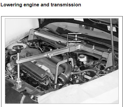

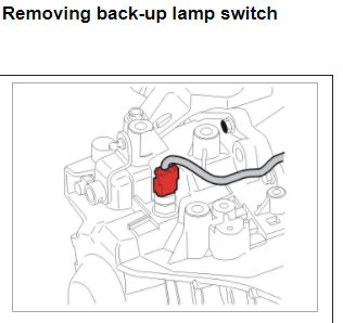

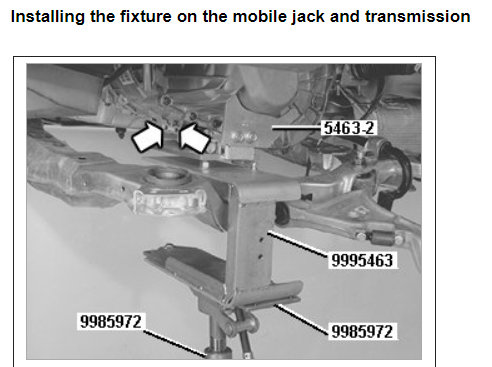

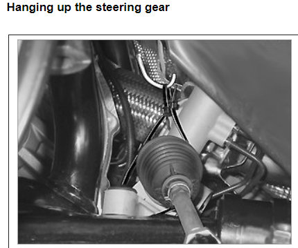

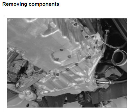

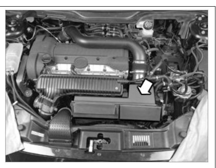

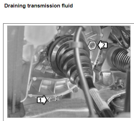

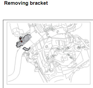

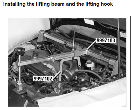

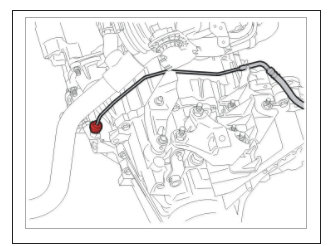

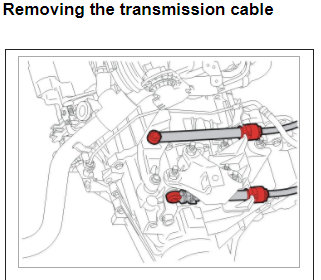

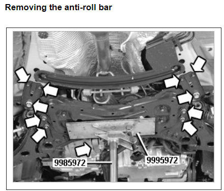

This sounds like the clutch disc is falling apart or the pilot bearing needs to be replaced either way the transmission needs to come out. Here is a guide to help you see what you are in for when doing the job:
https://www.2carpros.com/articles/transmission-replacement-removal-manual
and
https://www.2carpros.com/articles/how-to-replace-a-clutch
this guide can help as well
https://www.2carpros.com/articles/clutch-doesnt-work-sometimes-or-not-at-all
Here is how the job is done on your car.
Cheers
Jun 7, 2010 at 5:39 PM
RANDY HAYBIN
It was the clutch like you said, great site and great guides. You are noble doing this for free.
