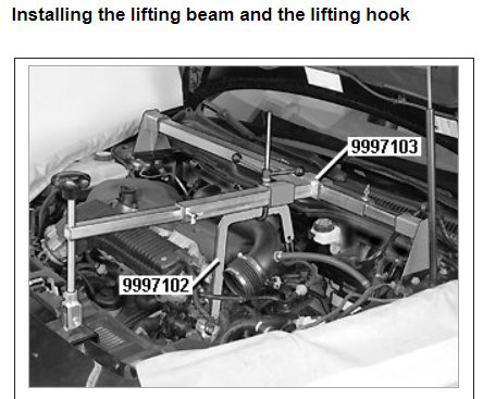

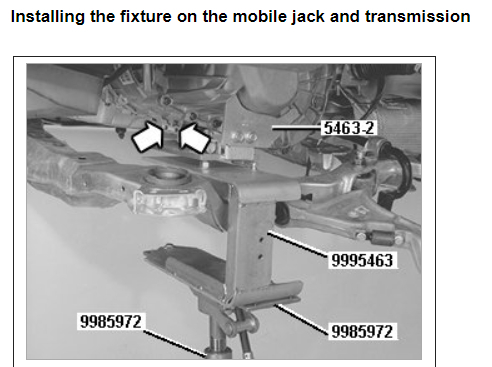

In the past 24 hours it has become very difficult to change gears. At the end of the journey i could not put the car in reverse gear? Is is gear lever bushes worn, teeth of linkage damaged or something more that those?
Jun 7, 2010 at 6:14 AM
JIS001
  • 3,412 POSTS

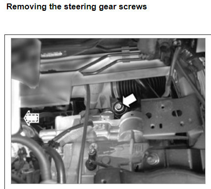

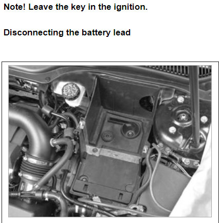

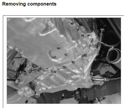

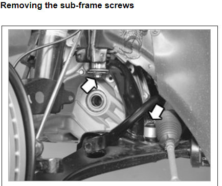

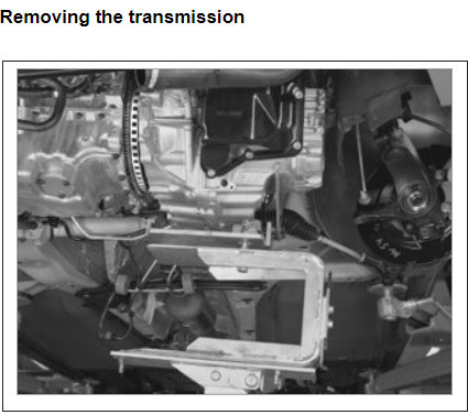

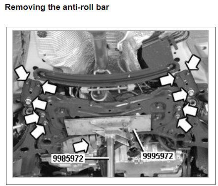

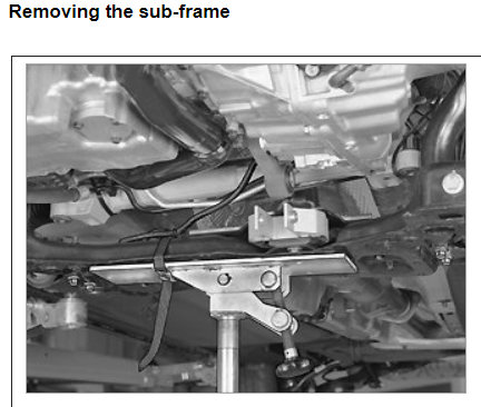

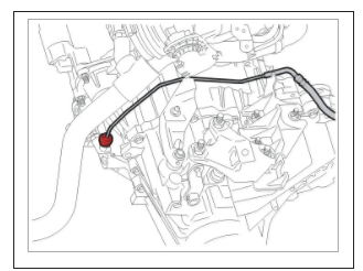

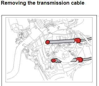

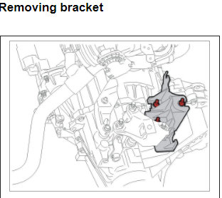

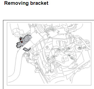

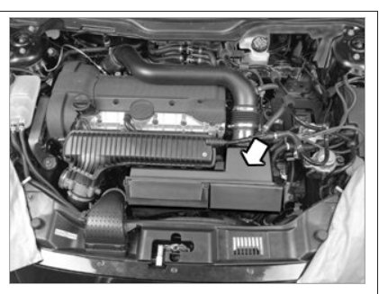

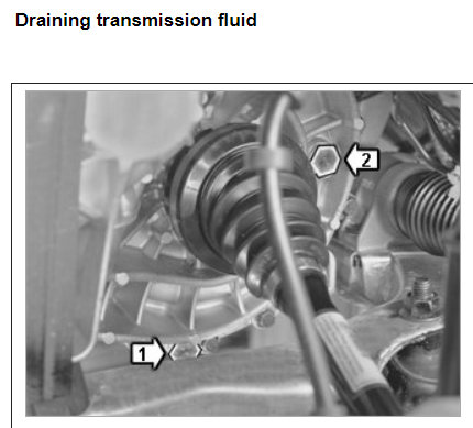

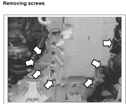

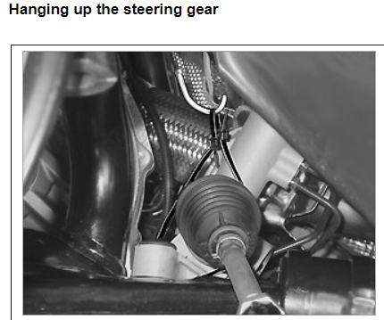

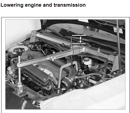

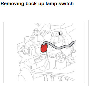

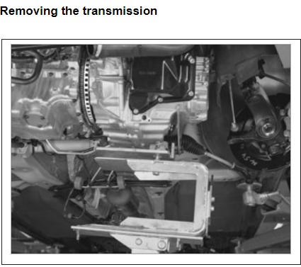

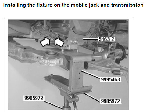

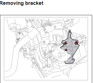

This sounds like the clutch disc is falling apart or the pilot bearing needs to be replaced either way the transmission needs to come out. Here is a guide to help you see what you are in for when doing the job:
https://www.2carpros.com/articles/transmission-replacement-removal-manual
and
https://www.2carpros.com/articles/how-to-replace-a-clutch
this guide can help as well
https://www.2carpros.com/articles/clutch-doesnt-work-sometimes-or-not-at-all
Here is how the job is done on your car.
Cheers

It was the clutch like you said, great site and great guides. You are noble doing this for free.
