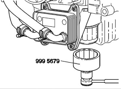

Hello! Could you tell me please where is oil filter on Volvo S40 1.6 2003? And how to change correctly?
Thank you!
Mar 20, 2010 at 2:29 AM
JIS001
  • 3,412 POSTS
Oil filter is located on the oil pan. You need to remove the black oil filter housing and cartridge will be in the pan. You need a special tool to remove the canister housing. Using filter pliers can cause the housng to crack since it is plastic.
https://images.2carpros.com/forum/automotive_pictures/337695_113644543_1.jpg

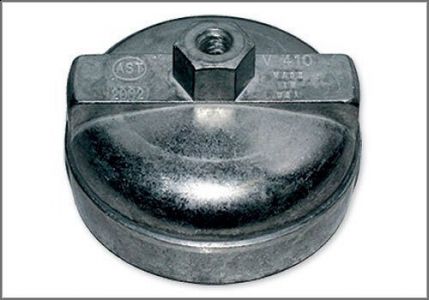

This is what the tool looks like. 86.5mm Oil Filter Wrench
https://images.2carpros.com/forum/automotive_pictures/337695_128848887_1.jpg
You may be able to rent the tool from your local parts store like AutoZone, Kragens, or a Pep Boys but you would need to call them an find out.
