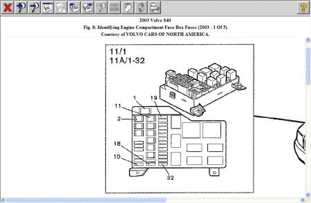

I HAVE JUST REPLACED THE GLOW PLUGS AS IT WAS NOT STARTING PROPERLY BUT NOW THE PRE-HEATER LIGHT DOES NOT COME ON AT ALL SO THE GLOW PLUGS ARE NOT WORKING,COULD THIS BE THE FUSE OR TIME DELAY SWITCH ? AND IF SO WHERE ARE THEY LOCATED? OR HAVE THEY GIVEN ME THE WRONG GLOW PLUGS WHICH ARE BOSCH 1St/Pc 0 250 202 022-4n3
. can you please help thank you PETER.
Jan 24, 2009 at 7:15 PM
KHLOW2008
  • 41,814 POSTS
Hi ALPINE, Thank you for the donation. The Glow Plug main fuse is the # 1 fuse in the underhood fusebox.
https://images.2carpros.com/forum/automotive_pictures/192750_FuseBox03VolvoS4001_1.jpg
The time delay switch seldom fails and you should check power supply to it if the main glow plug fuse is ok.
