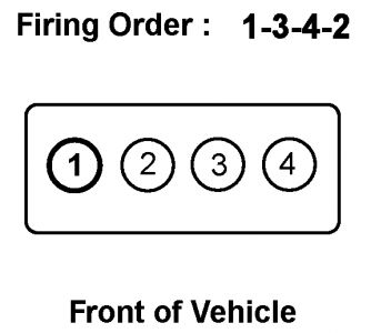

In 2001 Volvo S-40 1.9T, are cylinders numbered from (facing windshield) right to left or left to right? - Misfire cylinder 4 code.

Hi crmorrison,Welcome to 2carpros and TY for the donation-this is what keeps the site going. Check spark plug,compression and fuel injector on #4 cylinder.See below:
https://images.2carpros.com/forum/automotive_pictures/12900_fo_149.jpg
This diagram is wrong for Volvo s40 2001 1.9 turbo...the plug wire firing order is 1423..not 1342. thanks

if engine is misfiring, you may just need to replace the ignition coil and spark plugs. "misfire" fault typically does not mean the engine has a compression issue.
