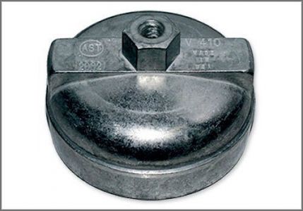

What is the best oil filter wrench to use to change the Oil filter with and is the oil cover cap a twist off type?

The oil filter is inside of a black, plastic canister which screws off. The oil filter is a cartridge type filter that you lift out.

The tool needed 86.5mm Oil Filter Wrench AST tool# V 410 - 86.5mm with 16 flats - Included in the 2100 Oil Filter Wrench Kit - Made of Aluminum - Durable
https://images.2carpros.com/forum/automotive_pictures/337695_128848887_2.jpg
