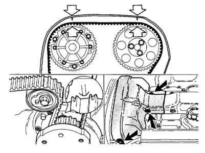

i just replaced my head gasket,know i am trying to set my timing is there any markings on the cams or any were to set the timing?how is the timing set?????
May 15, 2010 at 11:21 AM
JIS001
  • 3,412 POSTS

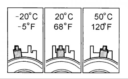

If you removed the cvvt hub on the exhaust cam then you will need the cam locking tool to set it up. Attaching the timing marks and where the tensioner needs to be set up.
