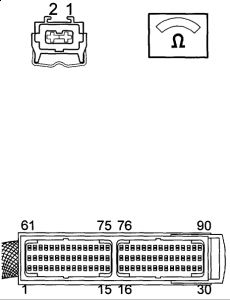

hello, after using the trouble code reader i got the code, P0113 Intake Air Temperature Circuit High Input, what does it mean and any suggestions on how to fix it will be appreciated, thank you.

Check the engine Control module (ECM) and intake air temperature (IAT) sensor connectors for contact resistance and oxidation according to Checking wiring and terminals - Intermittent Faults. Check in particular for damage, or loose terminal pins. Check the signal cable between engine control module (ECM) terminal 48 and intake air temperature (IAT) sensor terminal 1 for an intermittent short-circuit to Supply voltage. Remedy according to Checking wiring and terminals - Intermittent Faults and for an intermittent open-circuit Checking wiring and terminals - Intermittent Faults. Check the ground lead between engine control module (ECM) terminal 79 and intake air temperature (IAT) sensor terminal 2 for an intermittent open-circuit. Remedy according to Checking wiring and terminals - Intermittent Faults. Checking The Signal Cable Ignition on Disconnect the intake air temperature sensor connector. Connect a voltmeter between the intake air temperature (IAT) sensor connector terminal #1 (control module side) and ground. The voltmeter should read approximately 5 V . Checking The Ground Lead Connect an ohmmeter between the intake air temperature (IAT) sensor connector terminal #2 (control module side) and ground. The ohmmeter should read approximately 0 [ohm]. Checking Wiring And Terminals Check the cable between intake air temperature (IAT) sensor connector terminal #1 (engine control module (ECM) side) and engine control module (ECM) terminal #48. Check for a short-circuit to supply voltage according to See: Related Tests, Information and Procedures\Checking Wiring and Terminals Remedy as necessary. Checking Wiring And Terminals Check the cable between intake air temperature (IAT) sensor connector terminal #1 (engine control module (ECM) side) and engine control module (ECM) terminal #48. Check for an open-circuit according to Checking wiring and terminals - Permanent Faults. Check the cable between intake air temperature (IAT) sensor connector terminal #2 (engine control module (ECM) side) and engine control module (ECM) terminal #79. Check for an open-circuit according to Checking wiring and terminals - Permanent Faults. If all that checks out good then replace the intake temperature sensor.
