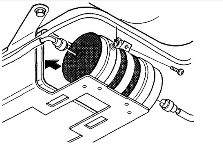

How do you change the fuel filter on this car?
Jul 9, 2010 at 7:55 AM
  • 54,839 POSTS
The fuel filter is located under the car near the rear of the car. You will need to jack the car up safely here is a guide to help you with that.
This next guide will give you an idea of what you are in for when changing the fuel filter.
https://www.2carpros.com/articles/how-to-change-a-fuel-filter
Here is a video to help you remove the lines from the filter even though it is a ford they are the same connectors.
https://youtu.be/Boi0DPXVHbM
Removal
Remove fuel filter from hose.
Slacken off quick-release connectors from fuel filter using an 17 mm open wrench.
Remove Torx 25.
Open the hose clamp.
Pull out fuel filter to the right.

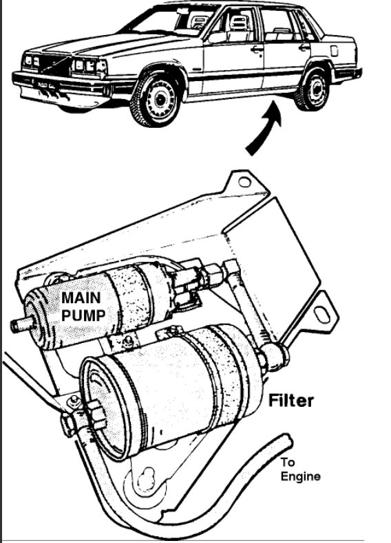

Is there a fuel filter at the top of the tank &/or Is there one in the tank ?
Dec 1, 2017 at 12:51 PM (Merged)
KHLOW2008
  • 41,814 POSTS
Fuel filter is located under right, rear of vehicle, in front of axle.
There are 2 fuel pumps however, one inside tank.
