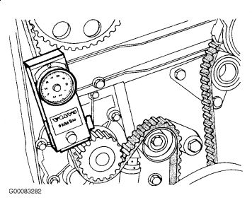

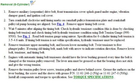

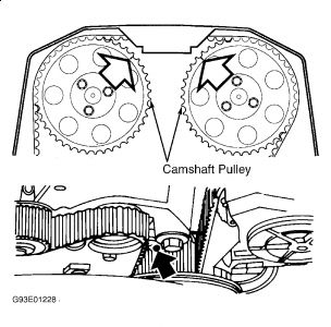

belt broke while driving, how to align timing to install the new belt?
Saturday, November 28th, 2009 AT 4:34 PM
MHPAUTOS
MECHANIC
31,937 POSTS
Hi there, see text and pics for details, Mitchell 1 advise that this is an
interference engine and valve damage will take place with a broken timing belt.
